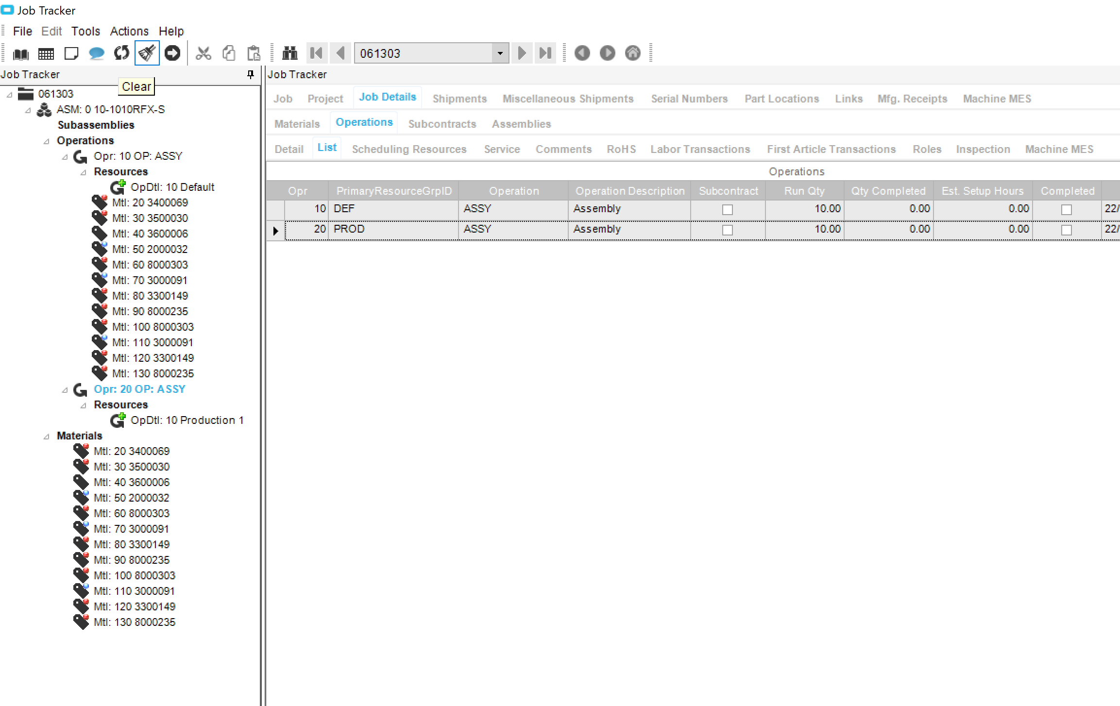

Can you post a screen shot of your expanded tree on the job?

Hi Brandon,
Sorry to bother you, but did you have a chance to look at the screenshot and do you have any idea where we’re going wrong?
Jonathan
So op 10 should be set to backflush, and op 20 should be set to time and quantity. Then when you complete op 20, op 10 will be completed when the backflush operation process runs.
