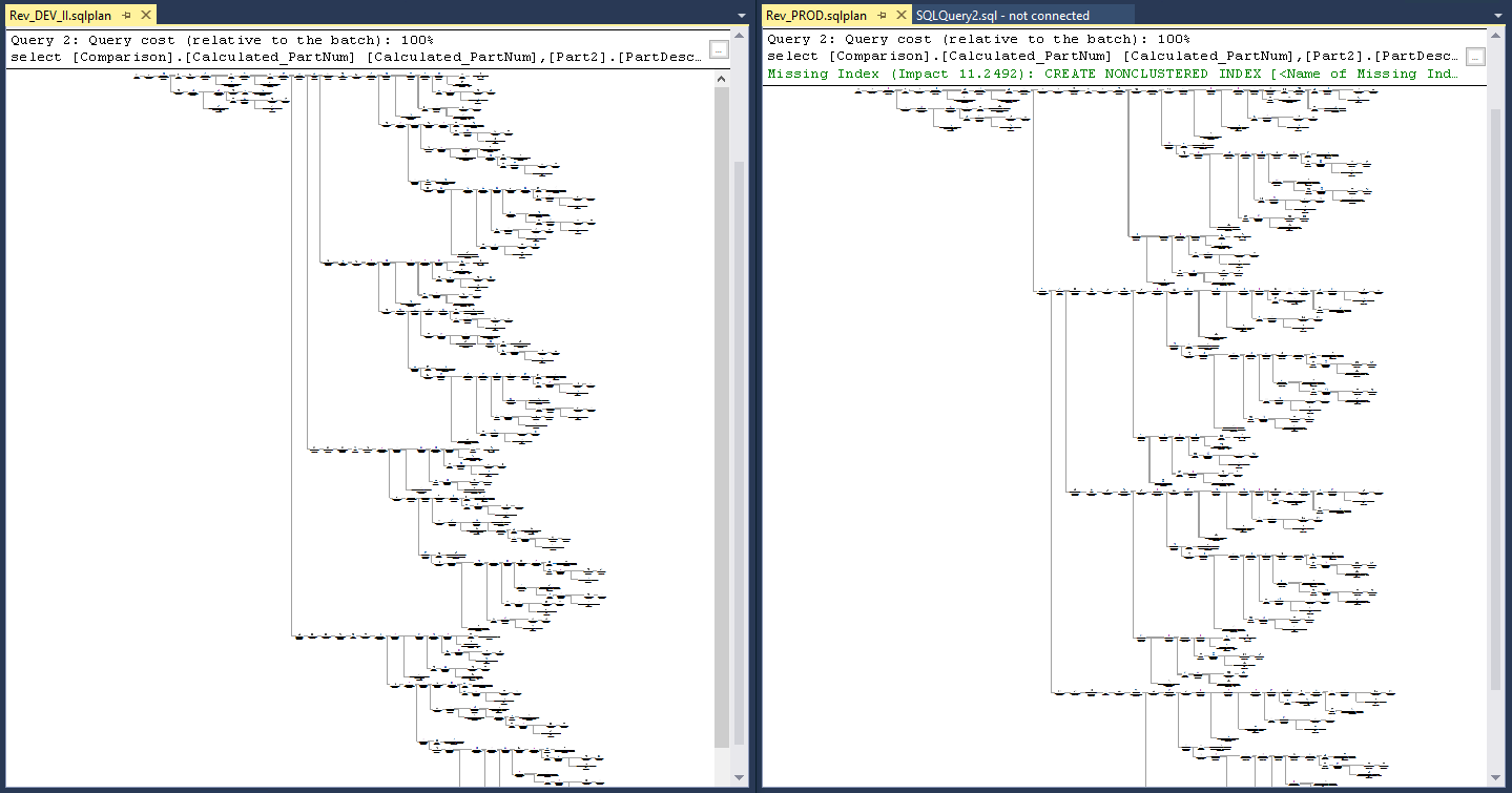

I did the SQL plan for each one. I know the pic is uber-small, but clearly they actually use a different flow to get there. WHY?

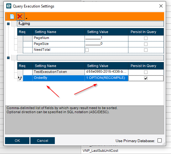

@josecgomez BAQ thing (in Production) did this:
Wow, is all I can say.
Just wow. 120 seconds → 0.9 seconds.
A bad plan will ruin your day, bad plans are usually because of bad statistics. I’d wager if you do the stats update and remove the recompile thing you’ll get similar results.
BTW that option recompile is a bit of a hack I’m sure you could tell, we are “injecting” a bit of SQL magic via that Order By Clause. So I can’t guarantee it’ll work forever

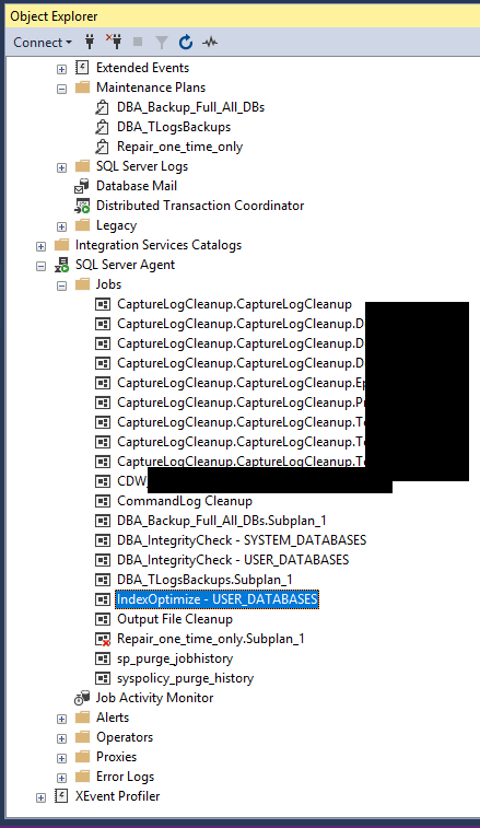

PS, you are right, of course, no statistics plan/job in SSMS that I see. I remember stats being an issue before, and I thought I/someone had set up something for that, but guess not.
Will do!

PSA for future readers, check off Persist in Query as Jose’s screenshot that I borrowed below shows. Otherwise it goes away after you close the window.
If it is anything like the QueryOldCompanySecurity setting, don’t even reopen the Execution Settings window, or if you do, click cancel. (See linked post below.)

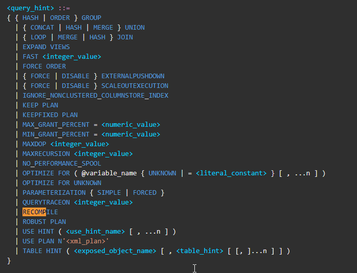

Either a Checkbox or an execution option would be nice the ability to control which plan / index / stat a query uses would be nice though too advanced for “generic” users. And I understand how allowin just arbitraty SQL Inject would be bad. So maybe a few pre-set options that can be selected just like we do that OrderBy Hack but with the a few (all ??) of the query hint options
If not at least the OPTION recompile one would be grand.
