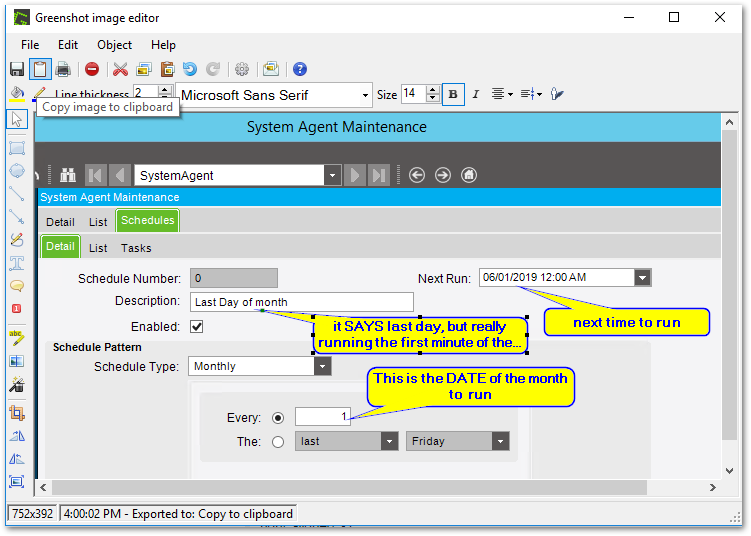

I use Greenshot.Com as my screen clipper of choice… it is free and super easy to use. Here is a screenshot of GreenShot that I posted earlier today (or yesterday?) I have greenshot setup to auto pop the selection window on Ctrl-Shift-P, and then it pops this window when done selecting so I can make notes.

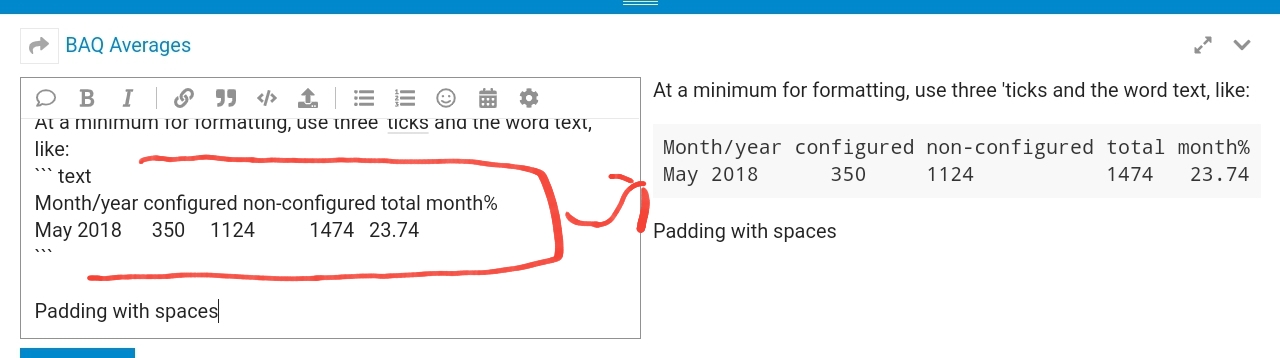

At a minimum for formatting, use three 'ticks and the word text, like:
To get
Month/year configured non-configured total month%
May 2018      350     1124           1474   23.74

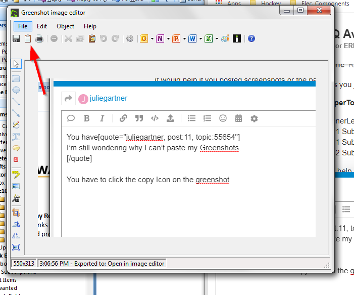

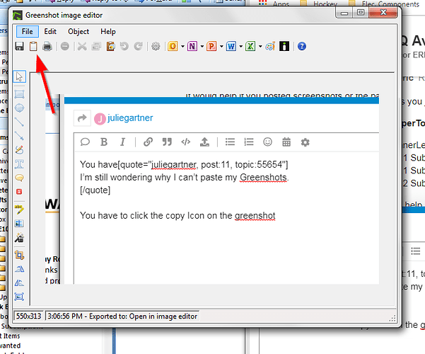

I’m still wondering why I can’t paste my Greenshots.
You have to click the copy Icon on the greenshot toolbar. I know the Edit menu says Ctrl+C is for copy, but it doesn’t
Edit
Turns out the Copy, Cut and Paste functions under the Edit menu are for doing those to objects added to the snapshot (like boxes, arrows, etc…)
