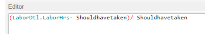

I chose “shouldhavetaken” from the dropdown menu of calculated fields and I cannot directly edit the SQL on the “general” screen.
I attempted to change “Shouldhavetaken” to “Calculated_Shouldhavetaken” in the editor but it errors out.

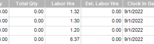

If you remove that calculation field, does query return something?
Look at the expression editor for the calculated field: Calculated_effpercent. You can edit the text in that expression editor to include the Caluclated_ prefix.
Tried that but when i check the syntax it says invalid column name.

Yes:
54 rows of information

Do I add this text into the editor of the calculated field?
Yes, that entire case statement can be put in the expression editor for your calculated field.
