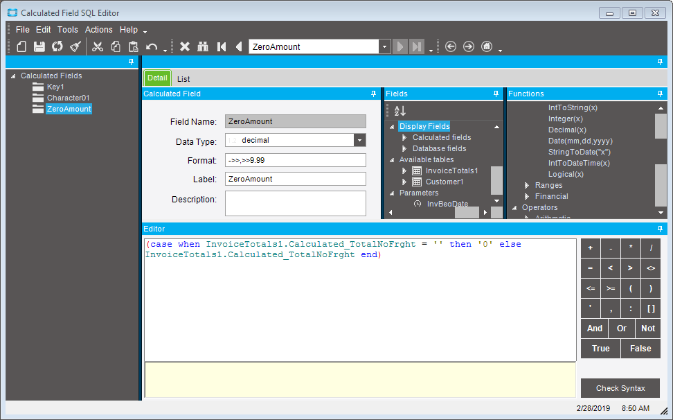

I have a BAQ with Subqueries. It basically totals up each invoice for Sales with no freight charges for a selected time period. I am trying to compare that with my customer list and for each customer that didn’t have an invoice for that time period, I want it to add a 0.00 to the Invoice Total Field so I can use it when I’m comparing sales from year to year. I have the Total Field that is a Decimal file. I have created a Calculated Field below:
When I try to run the Query, I get this error. It does Analyze as OK though.
then ‘0’

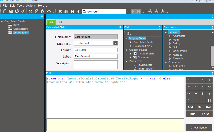

should be:
then 0
I tried that am I’m still getting the same error.
What is the type of InvoiceTotals1.Calculate_TotalNoFrght? Hopefully decimal
If its decimal, you cant do the first comparison = ‘’
If its a nvarchar, you cant assign it to your value (without a cast)

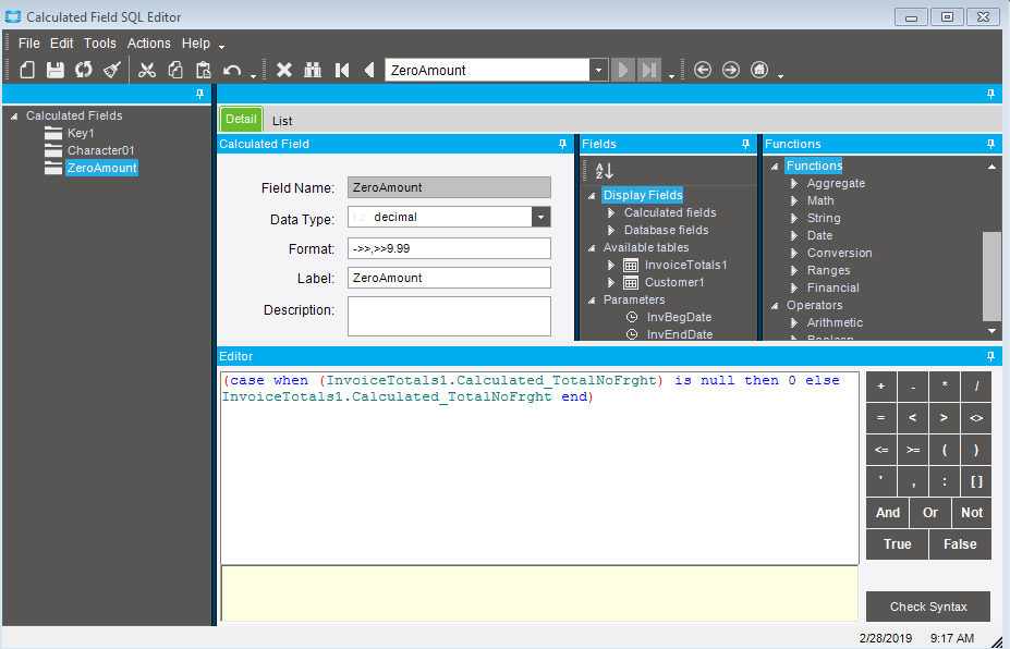

try ISNULL, as you can not compare decimal variable to ’ ’ blank
Thank you this worked!

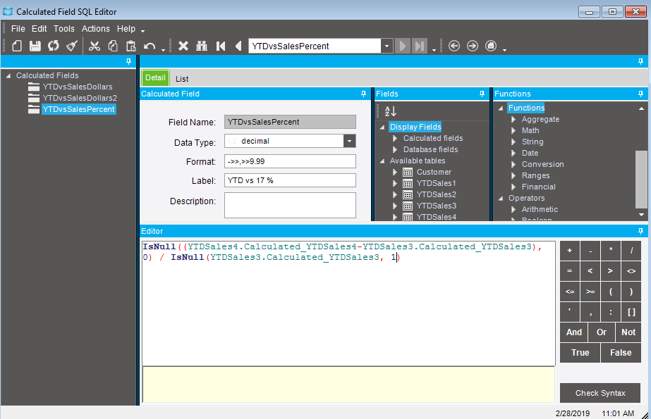

Okay, one more for you. I am trying to calculate a % on the Sales Columns. For some customers both columns might be null. I have this formula so far but am still getting an error.
Need to test for zero too.

(IsNull(YTDSales4.Calculated_YTDSales4,0)-IsNull(YTDSales3.Calculated_YTDSales3,0)) / MAX(IsNull(YTDSales3.Calculated_YTDSales3,1),1)
Also should test each of YTDSales3 and 4 as null before doing math.
Note: Should test for exactly zero. I cheated to just assume that the YTDSales3 will be either 0 or some much larger number)

(IsNull(YTDSales4.Calculated_YTDSales4,0)-IsNull(YTDSales3.Calculated_YTDSales3,0)) / MAX(IsNull(YTDSales3.Calculated_YTDSales3,1))
The MAX function won’t work.
Go back to using case when
and this is really SQL language not c# (I think)

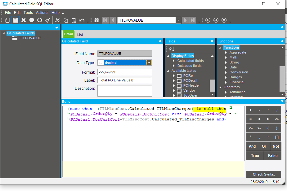

case
    when (OrderDtl.DiscountPercent) is null  then (IsNull(OrderDtl.UnitPrice,0)- IsNull(OrderDtl.DiscountPercent,0))/1
    when OrderDtl.DiscountPercent = 0 then (IsNull(OrderDtl.UnitPrice,0)- OrderDtl.DiscountPercent)/1
    else (IsNull(OrderDtl.UnitPrice,0)- OrderDtl.DiscountPercent)/ OrderDtl.DiscountPercent
end
DiscountPercent is YTD3, and UnitPrice is YTD4
The first when checks for YTD3 being null.
The second checks for YTD being 0
The third (else) is when it is neither.
I don’t check for YTD3 being null in the 2nd when, or else.
