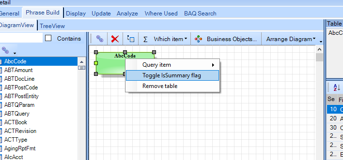

I think in E9 isn’t there something where you can right click on the Node and mark the table as a “Total/SUM” Table. (You right click on the green node in Designer).
The only way I always knew how to do it in E9 was to make an Updateable BAQ and use the BPM Editor in the Update Tab and add a BPM on the GetRows and then set Calculated_Fields via BPM on UBAQ.

In V8, I think there was a checkbox in the list of tables selected.
The faster he upgrades, the sooner I can retire my E9 VIrtual Machine, I keep around just for @Rowley150
I dont think I ever used this, feature - I am sure theres something in the E9 Help Files… But see if you can find/figure out how this works:
EDIT: It looks like you already know how to use this feature well, perhaps it doesnt work for what you intend to do with it…
Therefore, I think you might just end up with updateable BAQ, despite it not being used to update anything, you can then put BPMs on it.

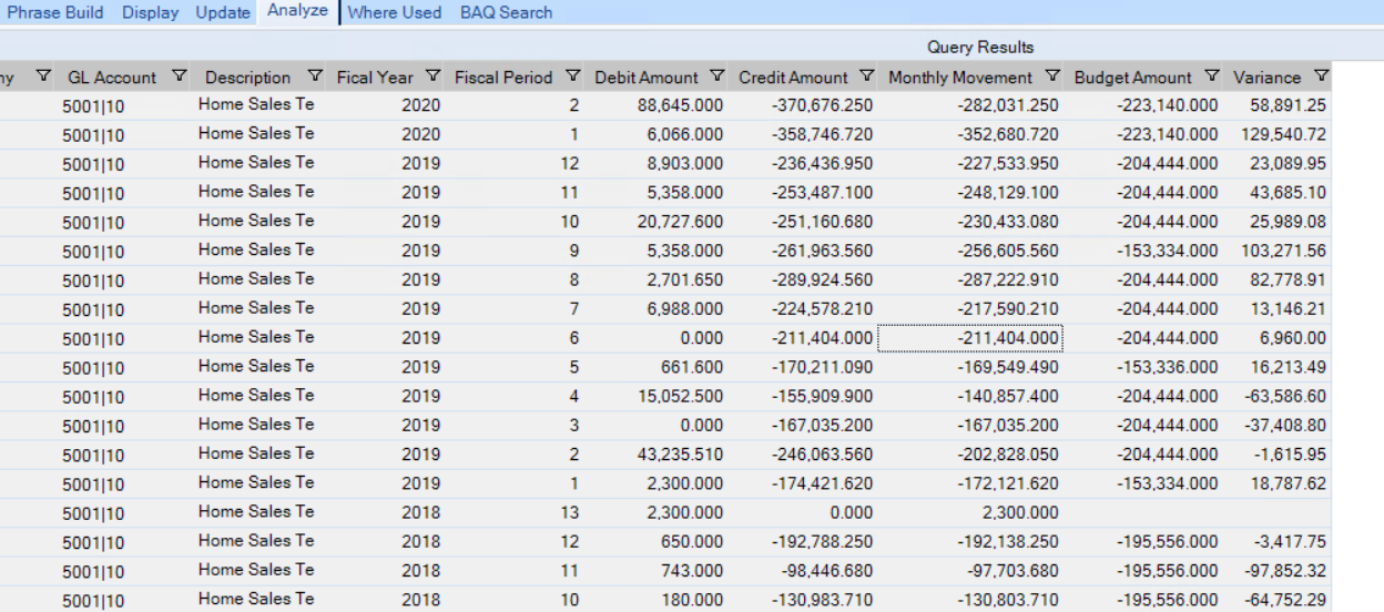

Calculated field syntax:
TOTAL (GLPeriodBal1.BalanceAmt) OVER (ORDER BY GLAccount.GLAccount, GLPeriodBal1.FiscalYear, GLPeriodBal1.FiscalPeriod)
summary table added:
exported to excel, here is what is happening:
columns B to J is what is exported from the BAQ…
column K is what i’ve done to work out what it should be…
column J seems to be doing something odd so i think the syntax in the calculated field needs a bit of tweaking.

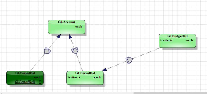

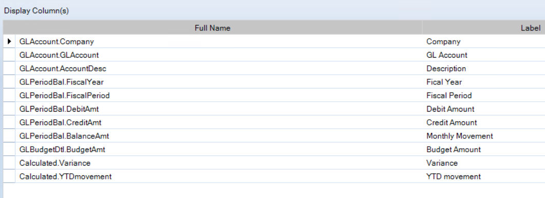

these are the display columns and labels.
the relationships:
when i make GLPERIODBAL table the summary table, i get this error:
