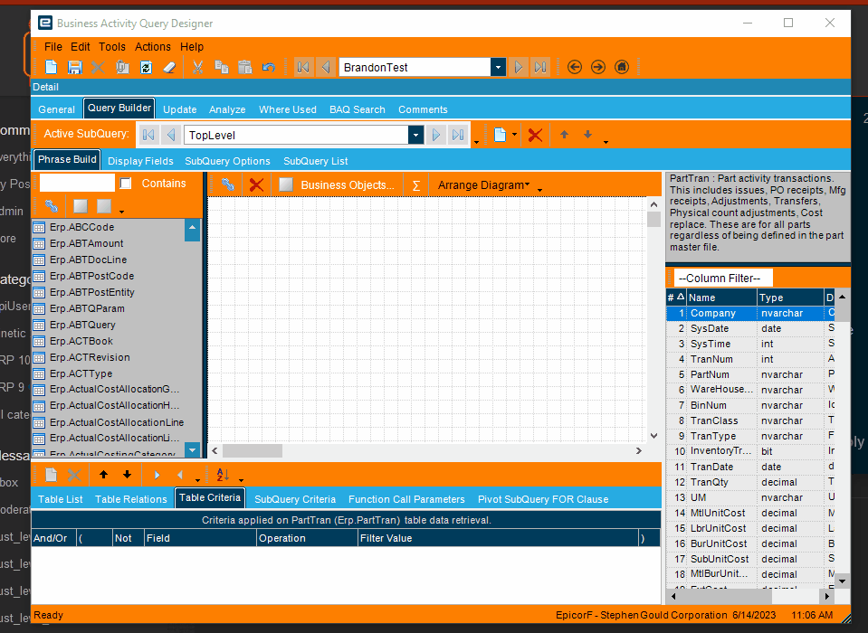

I go to Window 1, pull up the Calculated Field SQL Editor.
I click on the calculated field, go to Edit and select copy (Ctrl+V)
I close out of the Editor
I go to Window2, pull up the Calculated Field SQL Editor
Go to Edit and paste - no luck
Go to New and paste - no luck

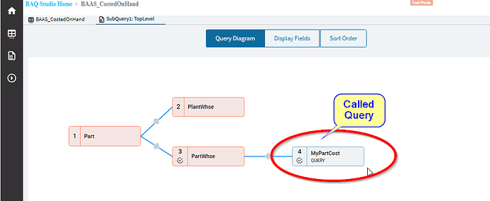

I just saw the demonstration of the new BAQ as a source for another BAQ story/idea mentioned above. IT WORKS… and works well…
Then I was building my own sample version, and tested it… IT WORKED, and it worked well, and easy.
  1. I created a BAQ that goes to calculate the unit cost for a part. This takes multiple tables. (Part, PartPlant, Plant, & PartCost)… each to retrieve necessary values to find the correct part cost (Plant to get the correct PlantCostID to get the correct PartCost record for the linked PartPlant)
  2. Now that i have that ā€œsourceā€ table, i am creating a second BAQ that will USE that baq… This BAQ uses the Part, PlantWhse (to get the plant that the warehouse belongs to), the PartWhse (to get the QTY On Hand), and then my lower level BAQ.
The result of this is that I can reuse my source BAQ many times in multiple queries.
BUT to get this new an exciting feature, you will need to upgrade to 2023.2, AND use the new BAQ Editor in the Browser (not available in the smart client).
