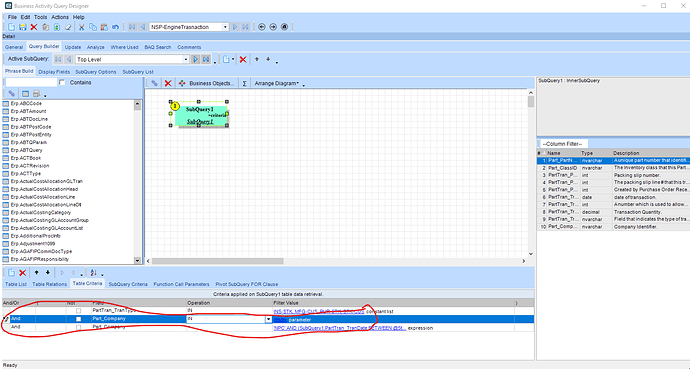

This is the problem, You can not chose the IN statement with the specified parameter filter value
If you have the operation set to IN the only parameter filter value is specified list paramter.
Is @Mfg a string or a list parameter? Can we get a screenshot of that definition? You can only use a list parameter for the IN criteria.
If the operation is set to = then you can choose specified parameter, if the operation is set to IN the filter value is narrowed to 3 options.
specified constant list / specified list parameter / field from specified sub-query.

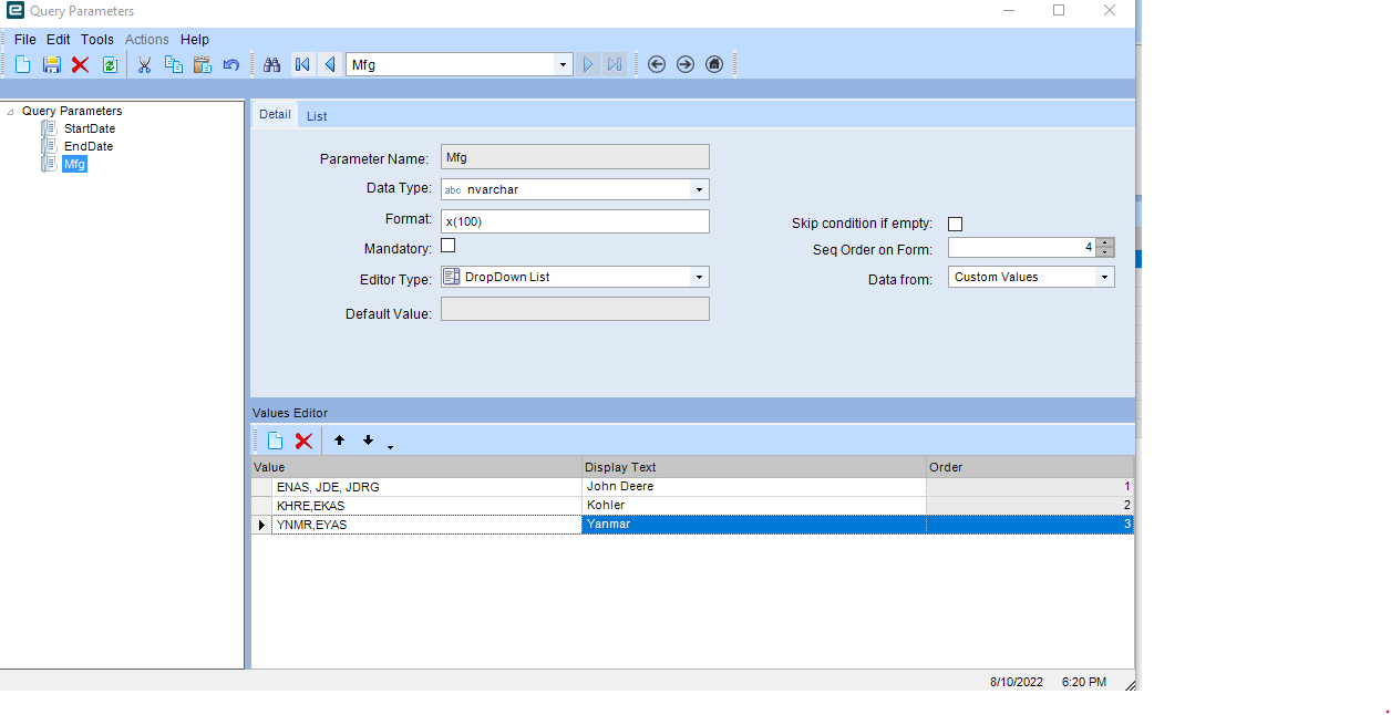

We have several ssrs reports that I am trying to convert to BAQ reports. These reports all have a drop down parameter that allows the user to pick several classid’s that are associated to a manufacturer. For example John Deere has a value of JDE,ENAS,JDRG. The previous crystal and ssrs version of the report used an IN statement to included records where the classid was one of those values.
For example here is the drop down parameter in the ssrs report.
And this is the Query from that same report.

I’m not quit following you. I currently have a parameter named Manufacturing. The first drop down has a display text of John Deere and a value of JDE,ENAS,JDRG. Those 3 values are all part class id’s. Then I have 2 more drop downs each with a display text and multiple values.
So Epicor is unable to use the IN statement because sees the parameter as a single value. I’m not sure how you would separate those values in a calculated field and if you did how would you use that to set the criteria?
