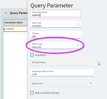

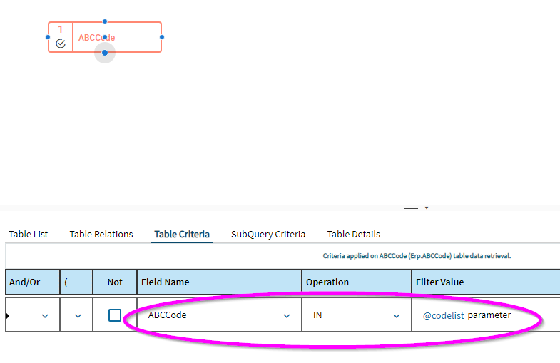

I Just tried this out in the latest version of Kinetic with the new BAQ UI… and IT WORKS. I originally thought it didn’t work, but then I realized that I missed a field in the definition of the parameter. I had to tell it that it was the editor type of “Item LIst” and then I could assign it to my condition.

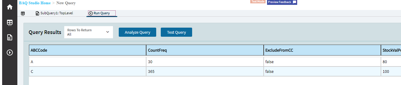

In my example, I put “A” and “C” into the list, and i only got back those two records from the BAQ results:

DropDownList was never supposed to work with IN operator. It just tells smart client what control should be shown to return 1 exact value - selected in combobox. So IN is not supposed to be used with that value.
You must use Item List in old or new BAQ designer as Tim showed above.
