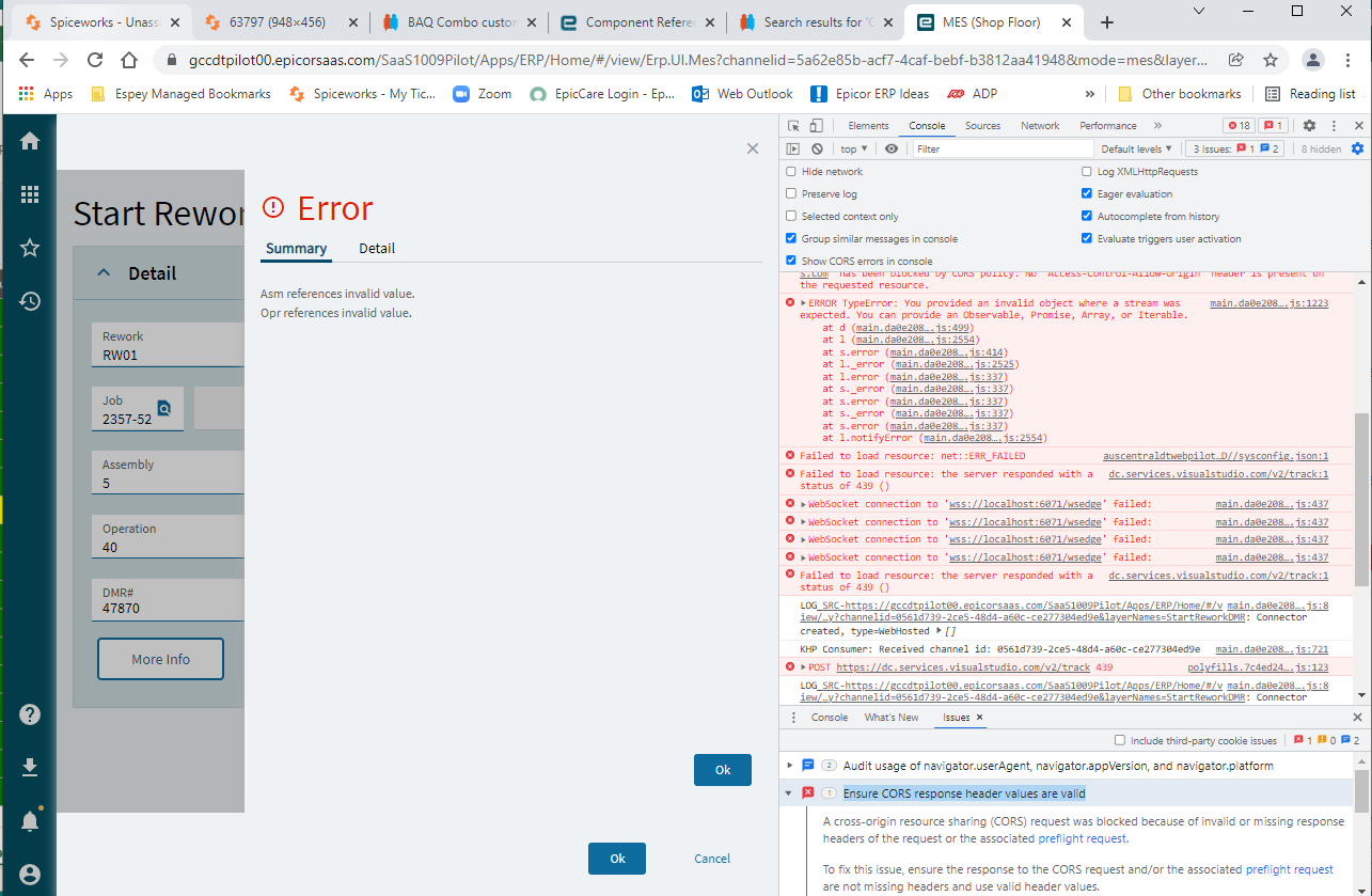

I think what is happening is once I select a DMR # from my new custom Combo, the Assembly and OprSeq I selected prior is lost so when I click OK and the ValidateReferentialIntegrity is executed the Assembly and OprSeq are null. Just not sure what in my custom Reusable Combo is causing this or what to do to resolve.

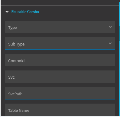

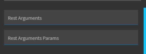

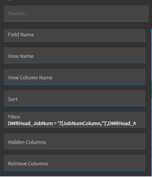

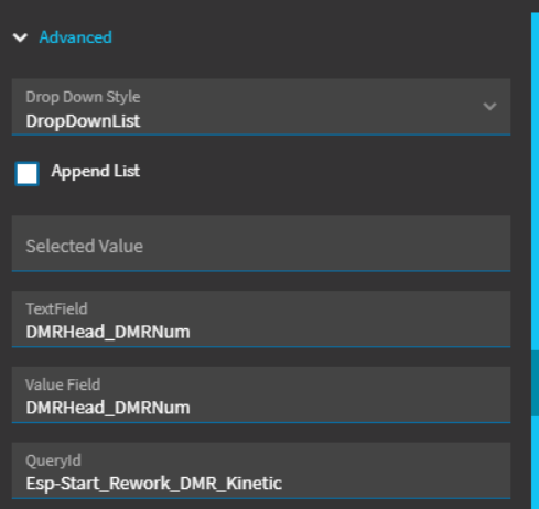

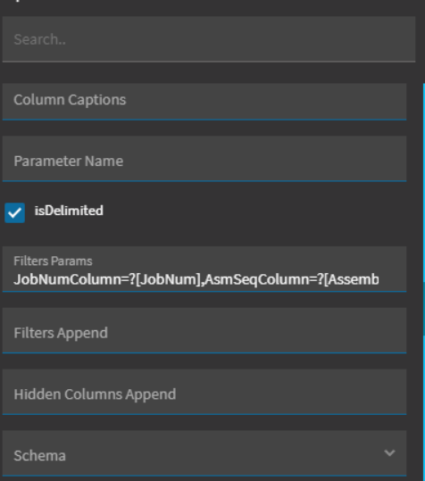

What do you have set for “display” and “value” waaaay at the bottom of the reusable combo?
Here is what I have under the Reusable Combo.
In the Advanced section I have:
That looks fine.

  3. Run your customization in the browser, enable Dev Tools and trace what Epicor is doing to look for clues.

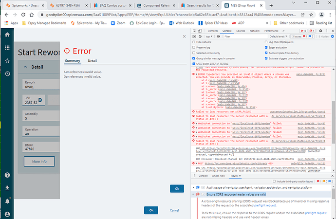

#3 - just tried this and while I am not very familiar with Dev Tool it seems to be returning an error “Ensure CORS response header values are valid”. I have no idea what this means.
Ah–sorry. You’ll have to do a bit more work for the Dev Tools: How To: Debugging Kinetic (Browser) - Experts’ Corner - Epicor User Help Forum (epiusers.help)
You can ignore the CORS message.
THANK YOU!!! Dev Tools helped me resolve the issue. The Data EpBinding was incorrect and was populating the DMR # selected into the LaborDtl.JobNum.
