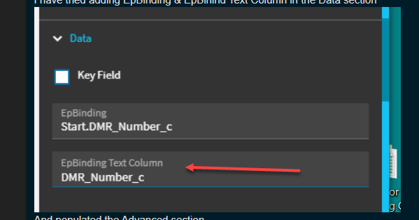

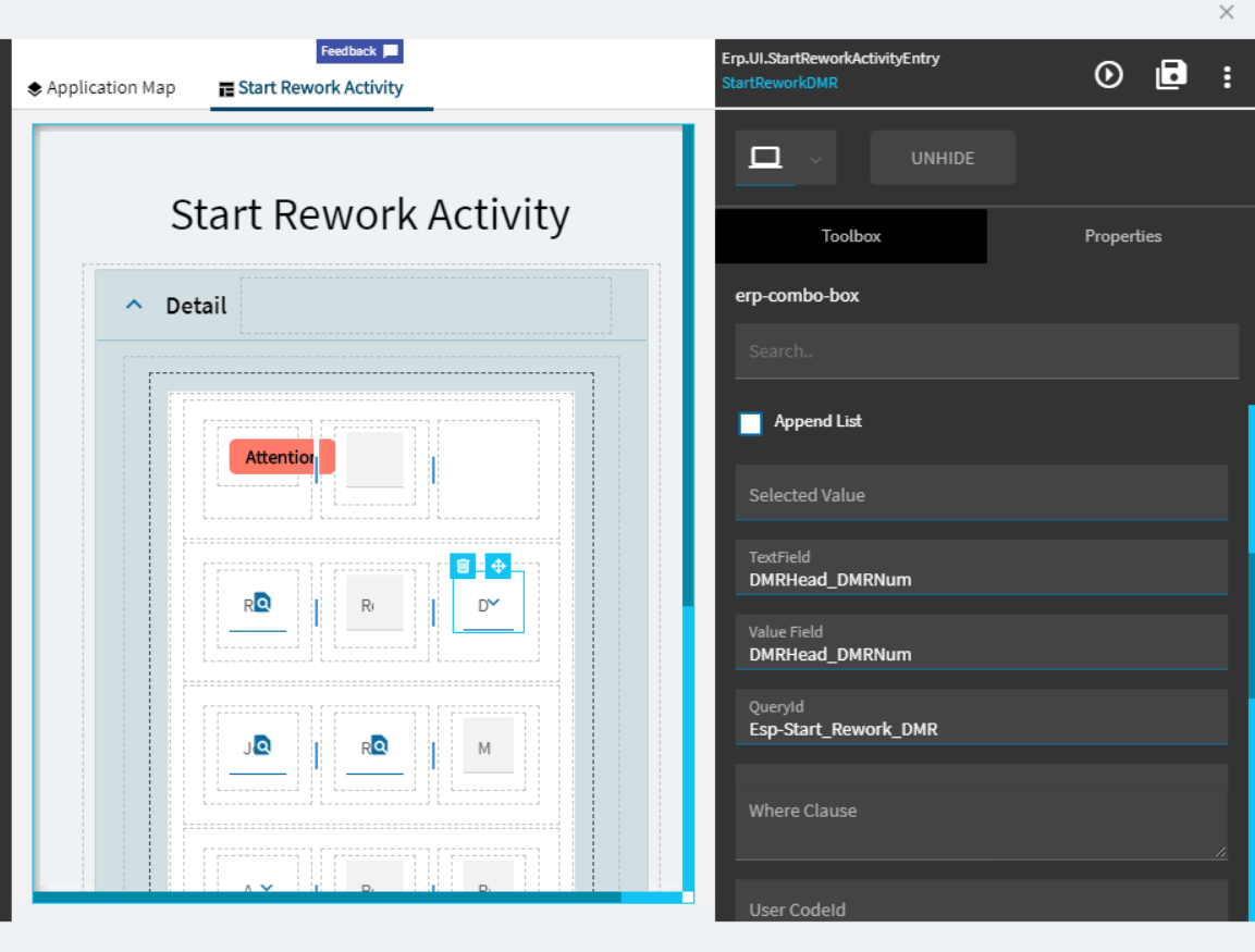

I have a Classic BAQ Combo customization on our MES Start Rework Activity menu and I am trying to convert this to Kinetic using Application Studio. The BAQ combo displays available DMR #'s based on the Job Num, Assembly, Operation entered/selected on the MES Rework Activity.
I can get the DMR # field to display on the kinetic menu but it is grayed out and I cannot figure out which setups in Application Studio to populate to trigger the BAQ which in classic returned the list to be displayed in the drop down.
I have tried adding EpBinding & EpBinind Text Column in the Data section
And populated the Advanced section
Has anyone figured out how to do this yet?

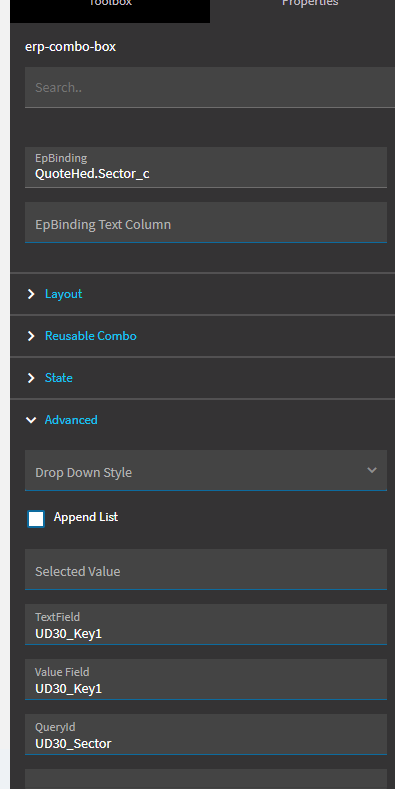

Make sure to populate the TextField property.
I must be missing something else or entering something wrong as I added the Textfield and still doesn’t work.

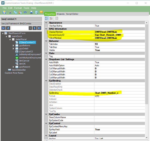

Here is what my Classic Customization looks like…
The BAQ used for this is as follows:
select
[DMRHead].[DMRNum] as [DMRHead_DMRNum]
from Erp.DMRHead as DMRHead
where (DMRHead.OpenDMR = 1 and DMRHead.JobNum = ‘[Like:JobHead.JobNum]’ and DMRHead.AssemblySeq = [Like:JobAsmbl.AssemblySeq] and DMRHead.OprSeq = [Like:JobOper.OprSeq])
group by [DMRHead].[DMRNum]
order by DMRHead.DMRNum

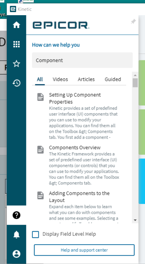

We had a similar and I got referred by Epi support to a help doc on using Filters in BAQ Combos and it worked for us

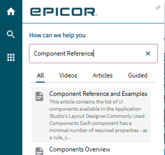

For some reason my help does not have the Component Reference and Examples

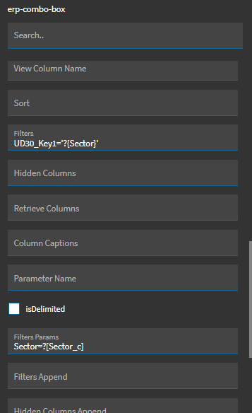

Try setting the Filters and Filter Params which are in the Reusable Combo section.
Filter field syntax is: Table_Fieldname = ‘?{FilterName}’.
Filter Params field syntax: FilterName = ?[fieldname]
I finally have victory using the Reusable Combo Section Filter and Filter Params fields. THANK YOU for the help!!! It was not the easiest to figure out the syntax that I required as I had 3 fields from my BAQ that I needed to filter based on the Job/Assembly/Operation selected on the MES Start Rework Activity screen.
Here are the filters I ended up getting to work…
Filters: DMRHead_JobNum = ‘?{JobNumColumn,’’}’,DMRHead_AssemblySeq = ‘?{AsmSeqColumn}’,DMRHead_OprSeq = ‘?{OprSeqColumn}’
Filters Params: OprSeqColumn=?[OprSeq],AsmSeqColumn=?[AssemblySeq],JobNumColumn=?[JobNum]
I also discovered I had the EpBinding in the Erp-Comb-Box wrong (was using Keyfields.JobNum and changed to LaborDtl.JobNum). I am now able to filter and return open DMR #'s for only the Job/Assembly/Operation selected - like I was doing in Classic.

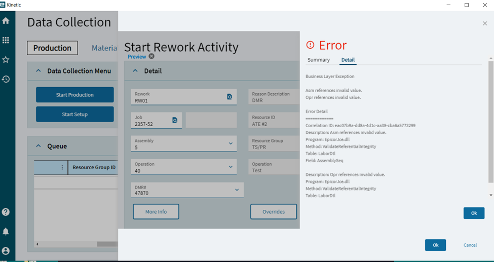

I am back…while this solution returns the expected DMR #'s once I click OK to continue working the Rework I get errors - Asm reference invalid value & Opr reference invalid Value.
Any thoughts?
