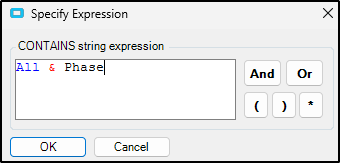

How can I use ‘ALL’ in a CONTAINS expression?

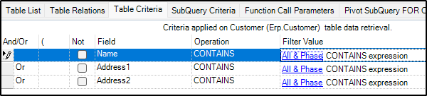

I have a customer “All Phase” and want to find all instances of it in the Name, Address1 and Address2 fields on the Customer table.
“ALL” seems to be a key word and it does not filter on it and brings back all results with “Phase” in the name.
Try
Like ‘%ALL%PHASE%’ on the three fields
or LIKE ‘%ALL[ ]PHASE%’
The %All%Phase% got me closest. Only one record where someone put an email address with a portion of the criteria to remove. (all-phasect)
