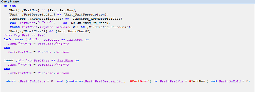

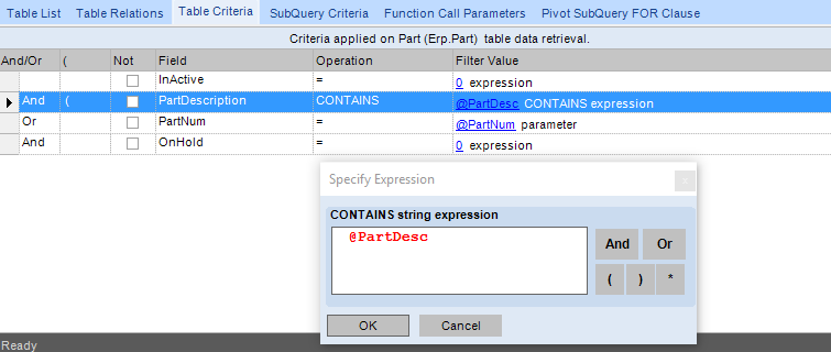

It would appear that when using the Contains comparer you are unable to use a parameter because it treats this like a string value.
Anyone have a workaround?

Can you explain a bit more what you are trying to accomplish. We use parameters all the time with no issues and we are using the contains and in.
sorry we are using the in and like operation with parameters. I am sure you can get it to work with like.
For your example like the @parameter, then use wildcards.
for example: %Description%
