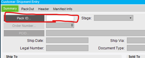

At current, my data view updates if I clear the form and reload, or if I spam the refresh button, but it only updates 50% of the time when someone reloads the form through a new Pack ID:
If there are any functions or methods I’m missing please let me know!
