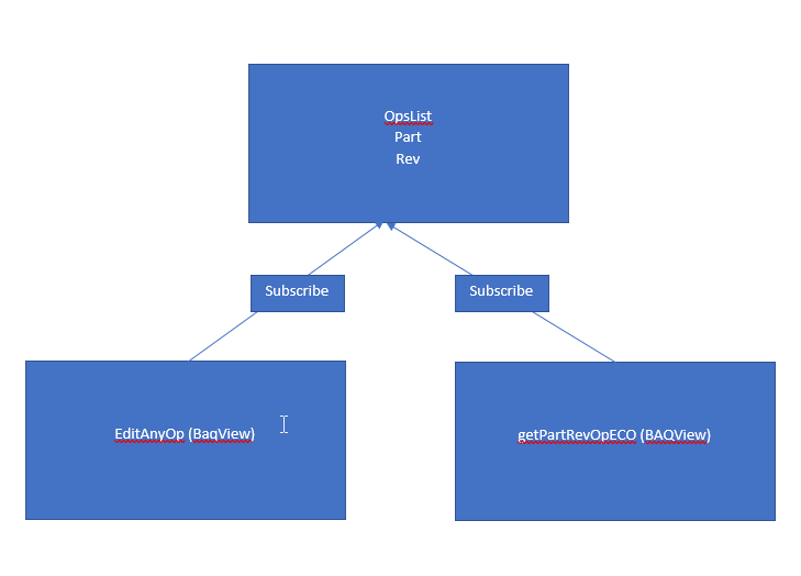

The process should be
Add BAQDataView
Register Pub / Sub Meaning register which fields in your other dataview will dynamically (and automatically filter the baq)
Tie BAQ to a Grid… what the magic happen

Just pub sub both of BAQDataViews to the same OpsList there shouldn’t be anything stopping you from doing that.
Is just a field it can be used for both filters.
Then any changes to Part / Rev on OpsList will trigger the Two BAQDataViews to re-run / filter.
I am missing something here. Right now I setup two BAQDVs. One is based on the PartRev table (OpsList1), and one is based on the EcoRev table (OpsList). Can you look at my SetupDV functions and let me know what I did wrong? I have see four DVs listed in my epibindings. OpsList, OpsList1, PartRevOps, and EcoRevOps. My grids are bound to PartRevOps and EcoRevOps.
I’m so confused!
LoL see the diagram above. You are filtering the BAQDataViews (both of them) by Part / Rev Right?
So there’s no reason to have two different Publishers. You create 1 EpiDataView call it OpsList then subscribe both the BAQDataViews to that single DataView
So your code could look like this’
