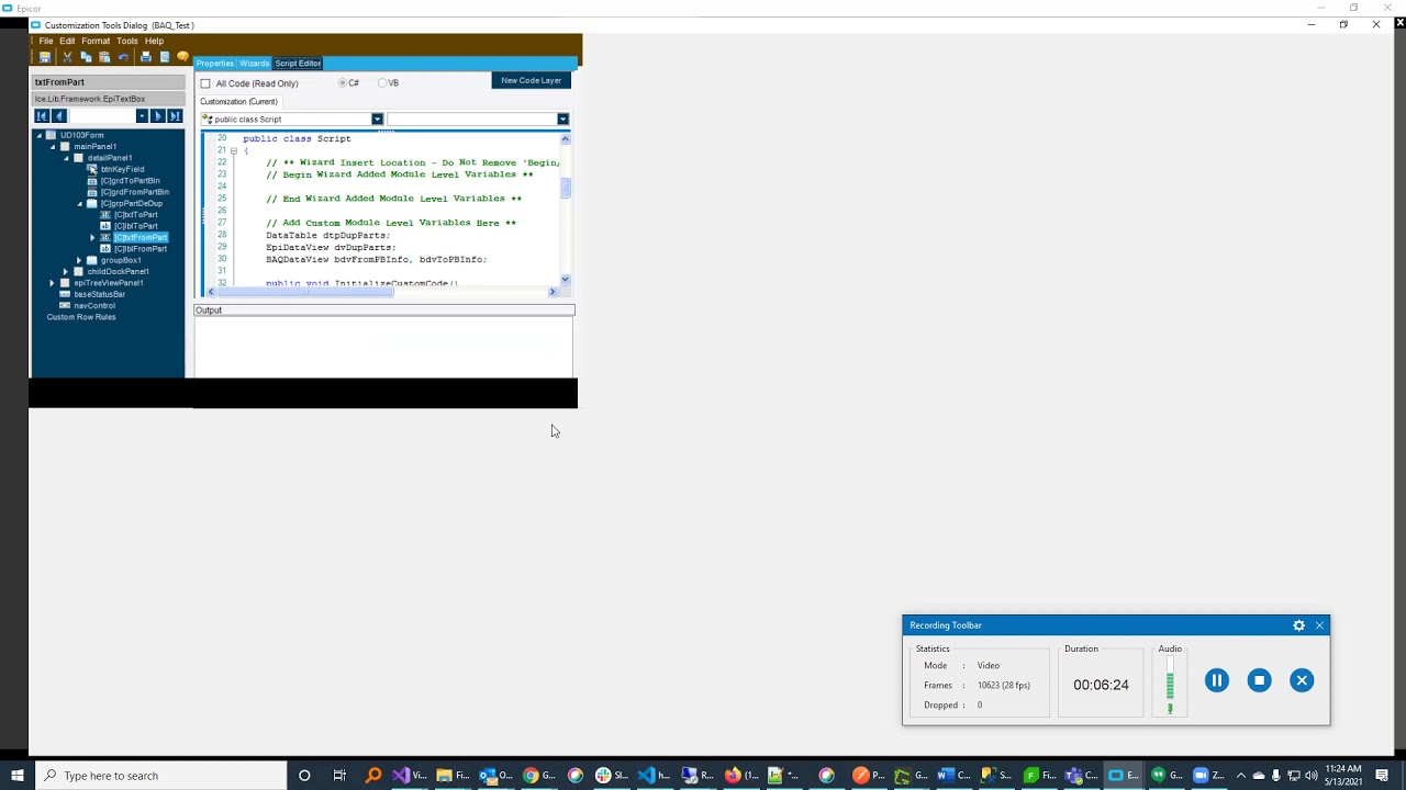

here you go @NateS hope this helps
Here’s the code to go along with it
// Custom code for UD103Form
// Created: 5/13/2021 11:15:16 AM
using System;
using System.ComponentModel;
using System.Data;
using System.Diagnostics;
using System.Windows.Forms;
using Ice.BO;
using Ice.UI;
using Ice.Lib;
using Ice.Adapters;
using Ice.Lib.Customization;
using Ice.Lib.ExtendedProps;
using Ice.Lib.Framework;
using Ice.Lib.Searches;
using Ice.UI.FormFunctions;
public class Script
	DataTable dtpDupParts;
	EpiDataView dvDupParts;
	BAQDataView bdvFromPBInfo, bdvToPBInfo;
		SetupCustomDV();
		// Begin Custom Code Disposal
		// End Custom Code Disposal
	public void SetupCustomDV()
		dtpDupParts = new DataTable();
		var colFromPart = new DataColumn("FromPart");
		colFromPart.ExtendedProperties["Like"]="Part.PartNum";
		dtpDupParts.Columns.Add(colFromPart);
		dtpDupParts.Columns.Add(new DataColumn("SysRowId",typeof(Guid)));
		var dr = dtpDupParts.NewRow();
		dr["SysRowId"] = Guid.NewGuid();
		dtpDupParts.Rows.Add(dr);
		dvDupParts = new EpiDataView();
		dvDupParts.dataView = dtpDupParts.DefaultView;
		oTrans.Add("TrackerView",dvDupParts);
		bdvFromPBInfo = new BAQDataView("PartDeDup_partbininfo");
		oTrans.Add("FromPartBinView",bdvFromPBInfo);
		var fromPBBinding= "TrackerView.FromPart";
		oTrans.PublishColumnChange(fromPBBinding,"FromPBPub");
		var fromPub = oTrans.GetPublisher(fromPBBinding);
		bdvFromPBInfo.SubscribeToPublisher(fromPub.PublishName,"PartBin_PartNum");
