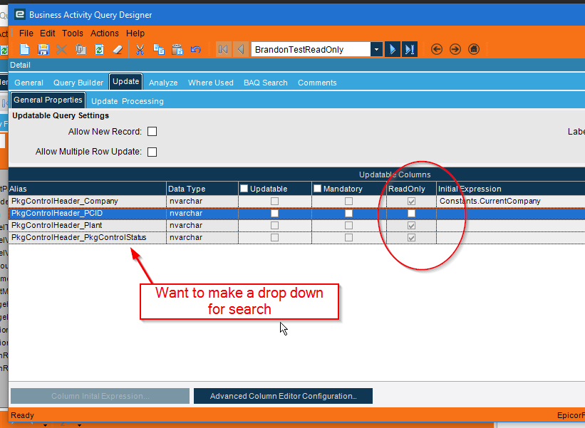

BAQ designer "Read only" fields prevents drop down creation for tracker search?

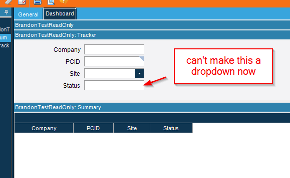

So, while trying to make a quick search for PCID (cause the stock one is broke as a joke right now), we (@josecgomez ) noticed that there’s a new “Feature” in which they make this read only check box so you can’t make the field a drop down (by faking the updateable and then using the advanced editor configuration). We use this all the time. This is a very common thing that we do for making tracker selectors without having to write any code or do customizations. @timshuwy was this intended to stop this? This is been a thing we’ve been using for years! Anyone else having problems with this?
you were probably 'using" an undocumented “feature” that was “fixed”. have you tried creating a service call? if you report it, and state the reasoning, the dev team may be able to research to find why it was done or if it is intentional.

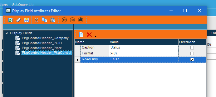

You can override the attribute.
So, it’s another step you have to take, but you can get around it.
Thanks @hkeric.wci for the suggestion.
I’ve noticed it in 10.2.700 even… so unless you made that BAQ earlier and it just remained checked. Its nothing new in Kinetic.
