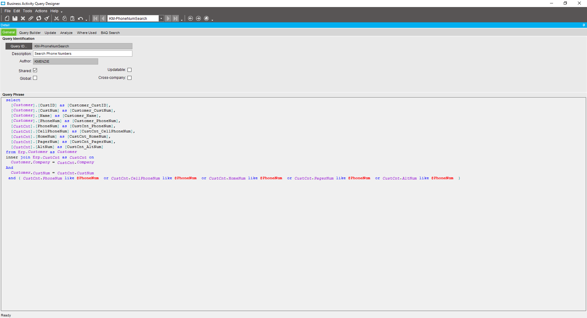

Been tasked with creating a BAQ where a user can type in a known phone number and the BAQ returns any matches to stored customer or customer contact numbers. (Could be the number for the main customer office or a contact’s mobile).
I’ve entered the parameter so the user can type in the phone number, and have set criteria on the CustCnt table to return any records where the phone number fields are like the number being searched.
But how do I set it to search BOTH the customer and custcnt tables for a match?
Ideally I want to see if the phone number is LIKE
Customer.PhoneNum
OR
CustCnt.PhoneNum
OR
CustCnt.CellPhoneNum
OR
CustCnt.HomeNum
OR
CustCnt.AltNum etc.

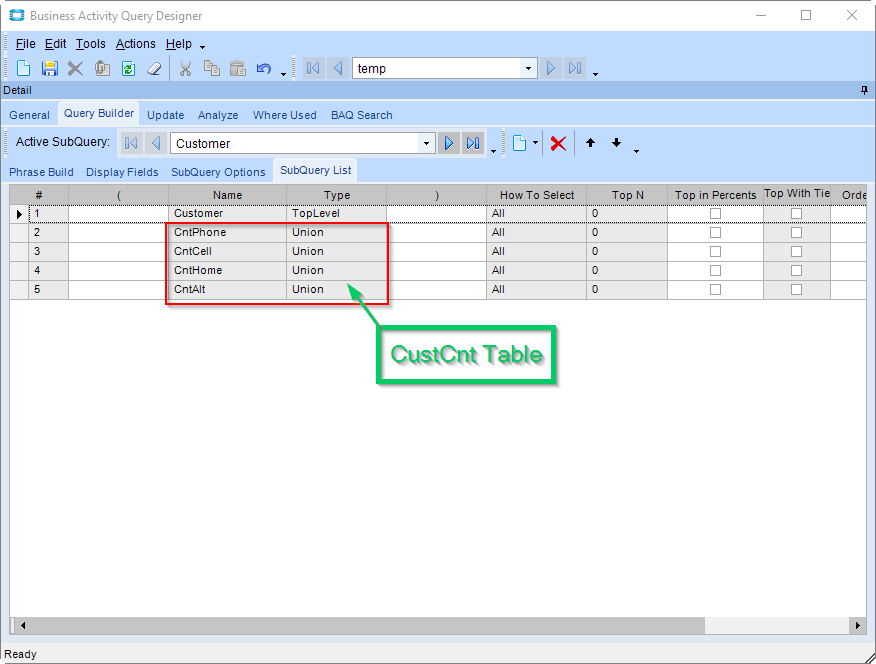

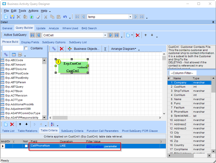

Union SubQueries on the CustCnt table for each phone number field and set the table criteria for each query to the parameter…
Thank you Brian!
I had tried subquery but put it all in one instead of separately.
Have tried your suggestion and it works, thank you.
