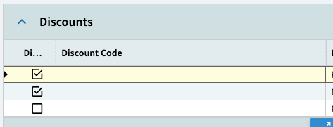

Here is the UI, where the Discount column is a BAQ dropdown. This grid loads collapsed, but when opened, no values are loaded even though there is data in the dataview:

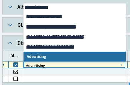

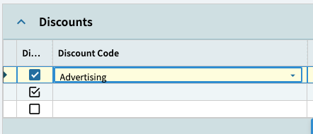

And when the cell is clicked, I get the value to appear:
And the dropdown is working as expected and correctly binding:

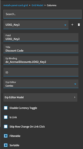

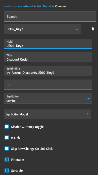

Here is my Column setup for that field :

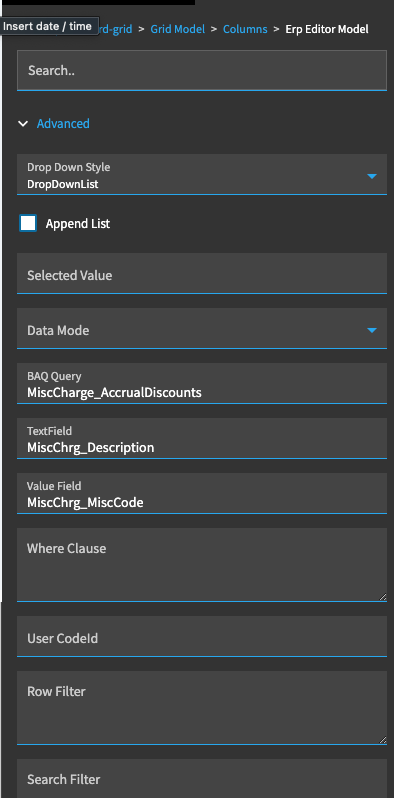

And here’s my Erp Editor Model :

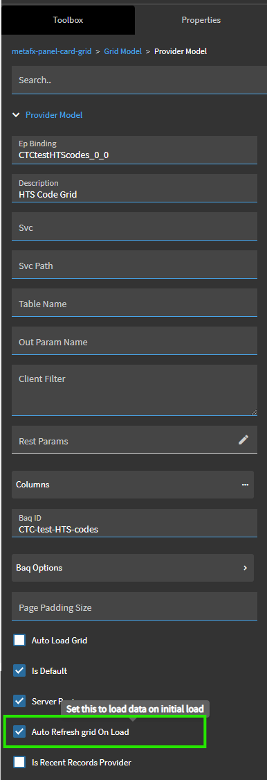

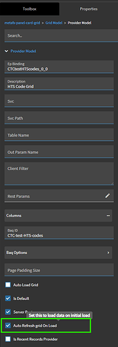

Just curious @Mathew, do you have ‘Auto Refresh Data on Load’ enabled? This ensures BAQ results load in the grid automatically on the initial load, without needing to click the refresh button. It might help populate the dropdown in your grid.
I tried that and still got the same result. Pesky thing…
