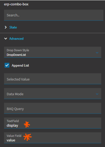

Hardcoded list : set the following under Properties:
  1. Data > EpBinding = View.Column e.g. SearchFilters.ProjectStatus
  2. Advanced > Drop Down Style = DropDownList
  3. Advanced > Append List = checked
  4. Advanced > TextField = display
  5. Advanced > Value Field = value
  6. Add the list items under Advanced > List

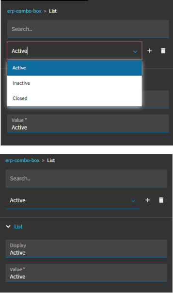

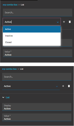

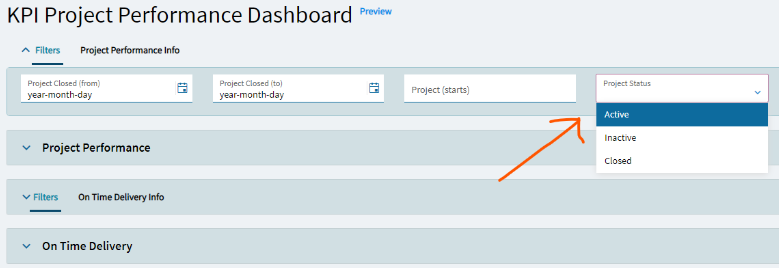

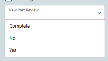

Hardcoded List example:

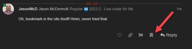

Don’t forget you can bookmark too
Oh, bookmark in the site itself! Hmm, never tried that.
Oh, cool, it can send you a reminder on the bookmark!

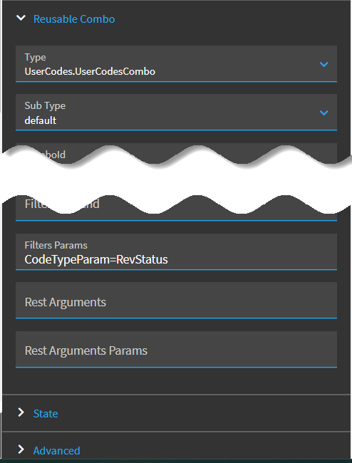

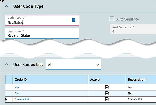

To use UserCodes -
First setup the UserCode Type and a list of values.
This is how to setup the Reusable Combo.
End result

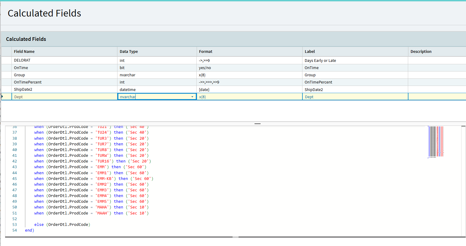

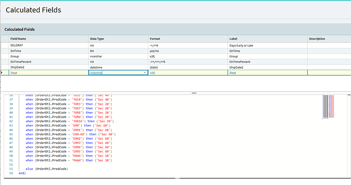

@tpogue: I created a BAQ for on time delivery, they want it broken down into department and then again into industry. (2 calculated fields like the below)
I tried to use the Hardcode list instructions to add a combo box to list the different departments as we want them to show, but Kinetic is not recognizing the custom fields. In Classic, when I manually added a Combo Box, I would enter Calculated.Dept in the Epi binding and then create a static list.
When I use the steps above in Kinetic, it will not return any results.
