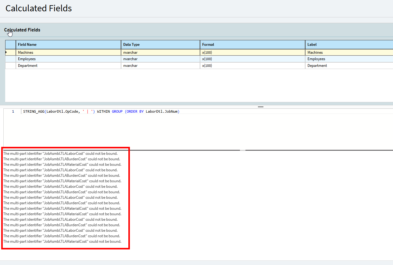

BAQ Error -- The multi-part identifier "JobAsmbl.TLALaborCost" could not be bound
Running into this error when I add a subquery. I don’t know if it has something to do with my formulas or the joins with the subquery. With the formulas, I’m trying to avoid having multiple lines for the same jobs show up on the BAQ… Full disclosure – I’m a BAQ novice!

I formatted the code with grave accents for readability. The only thing I see is one join I think is wrong of Company to JobNum. Do you have access to the server logs? You could look at the query Epicor generated.
I don’t have access to the logs -we are on public cloud.
Do you know what formula I would aggregate multiple resources or multiple employees so lines are getting duplicated? Do you have any suggestions there? And would this need to be on a subquery?
Did it get better with the join fixed? I would assume that the string_agg would be in a subquery.
You should be able to group all of the fields and use that field for the rows you need combined. You can’t group in a calculated field like that, so remove that part of the calculation.
A subquery would work too though.

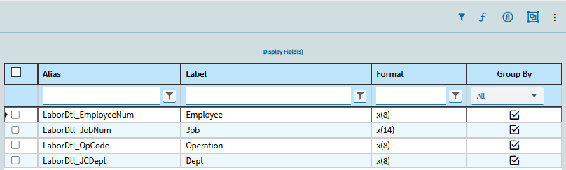

I tried this route - Added the LaborDtl table as a subquery. Grouped by all fields. Removed all Calculated fields.
I don’t get an error which is great, however, I’m getting duplicate lines if more than one employee worked on a job or if the job was manufactured on two machines. Any ideas?
well, it can only group rows if the fields are the same. If you have more than one employee number, you’ll get a row for that, since that row is no longer the same. So you’ll have to replace the field that you want to combine with a calculated field, like the string agg formula you have above. Then remove the actual field.
This would be the calculated field.
STRING_AGG(LaborDtl.EmployeeNum, ' | ')
Keep in mind, if you do this all on one level, string_agg() won’t remove duplicates. So if you have the same employee number clocking into the same op twice, their number is going to show up twice in the calculated field. To remove duplicate values and set the order of things if they aren’t ordered correctly, you’ll need to do a subquery to remove actual duplicates, then on the next level up use these calculated fields to combine the non-duplicate fields that you want to combine.
Ok, got it. This is where I’m going wrong. I need a subquery on the subquery. But I have to ask, what formula do I use to remove the duplicates? I’m a little lost.
If you group all of the rows, then they will condense down to unique rows. Or you can cheat and use the “Distinct” setting on the subqeury options. Then use you aggregate functions (like Sum() Count(), string_agg() etc.) to do thing with the fields that aren’t duplicated that you to combine into those rows.
