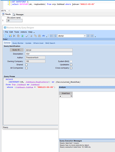

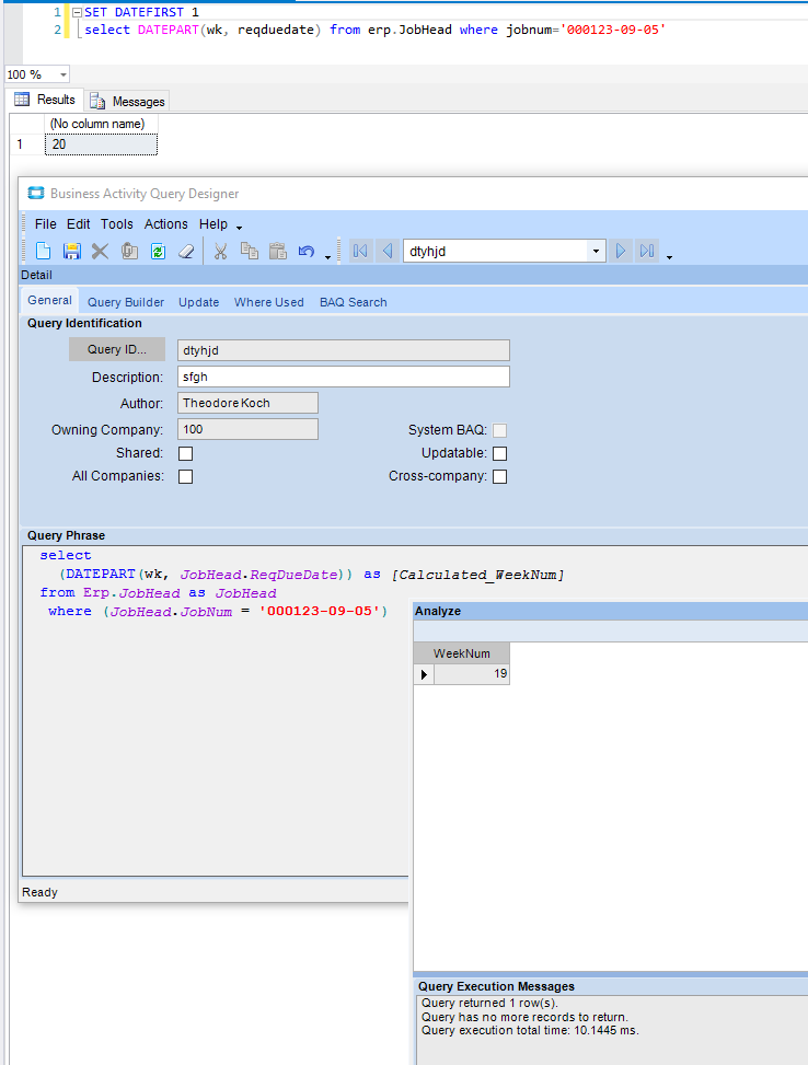

Correct, so the query actually would reflect Monday as being the first day of the week, rather than Sunday (the SQL default).
Where are you trying to stitch this in? In a bpm widget, c# code, a BAQ…
BAQ.
So, if I want to run a query and group by week number, the week numbers do not match our payroll calendar because our calendar runs Monday to Sunday, not Sunday to Saturday.
I can do this in SQL with DATEFIRST.
