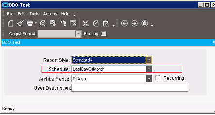

Then if your lucky, may not be too involved, something like this?
Remove the existing parameters and add calculated selection criteria to the BAQ - based off of “Today”, (or new copies of the BAQ/SSRS for the “scheduled” version).
Then submit the recurring report schedule with a run date that will match “Today” in your BAQ?
@bordway Thanks for the direction! I was just thinking too hard about this. Ended up just using datepart etc in the Calculated fields.
