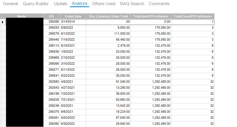

In order to do that, I would need to add the orderdate to the display column in BAQ, but doing so would ruin my BAQ as it would not return any result if I do that. However if I don’t pull it out, I can’t filter the orderdate in dashboard

You could turn on sums in the dashboard and use the dashboard grouping as as an alternative
to the summing subquery.

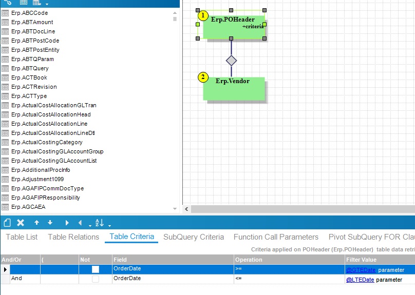

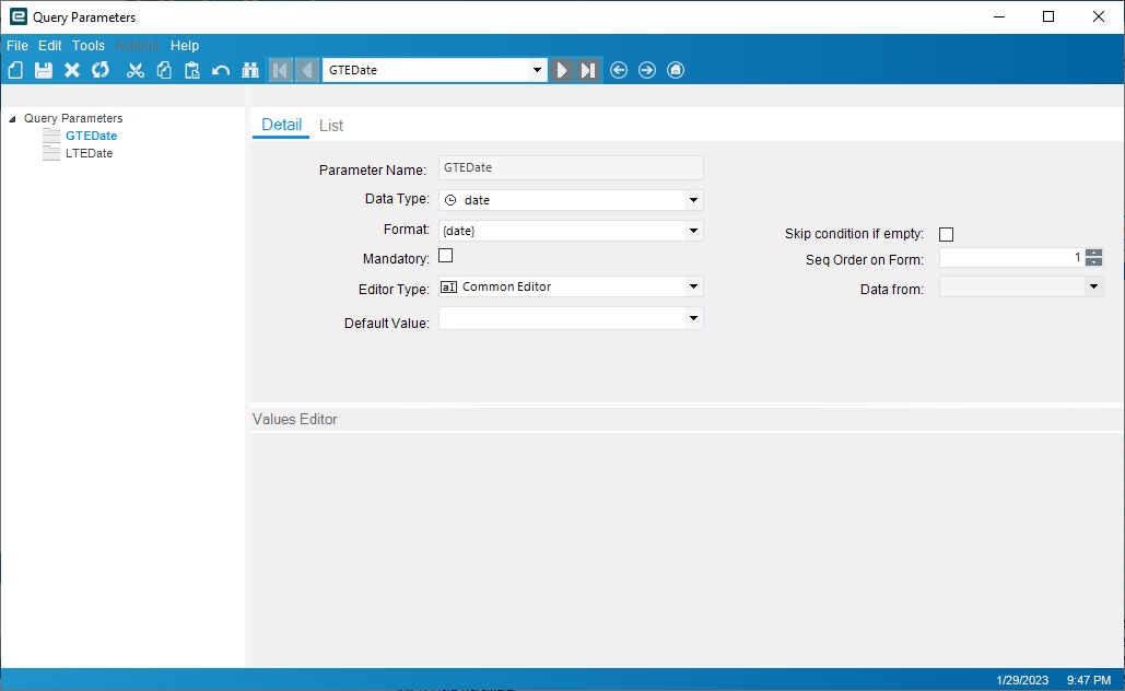

Yes, you could use a parameter, and filter in the criteria.
You wouldn’t SEE the dates, but it would return the correct data.
Your first query is fine for that.
Actions → Define Parameters
You’re a lifesaver!!! That’s exactly what I’m looking for.
