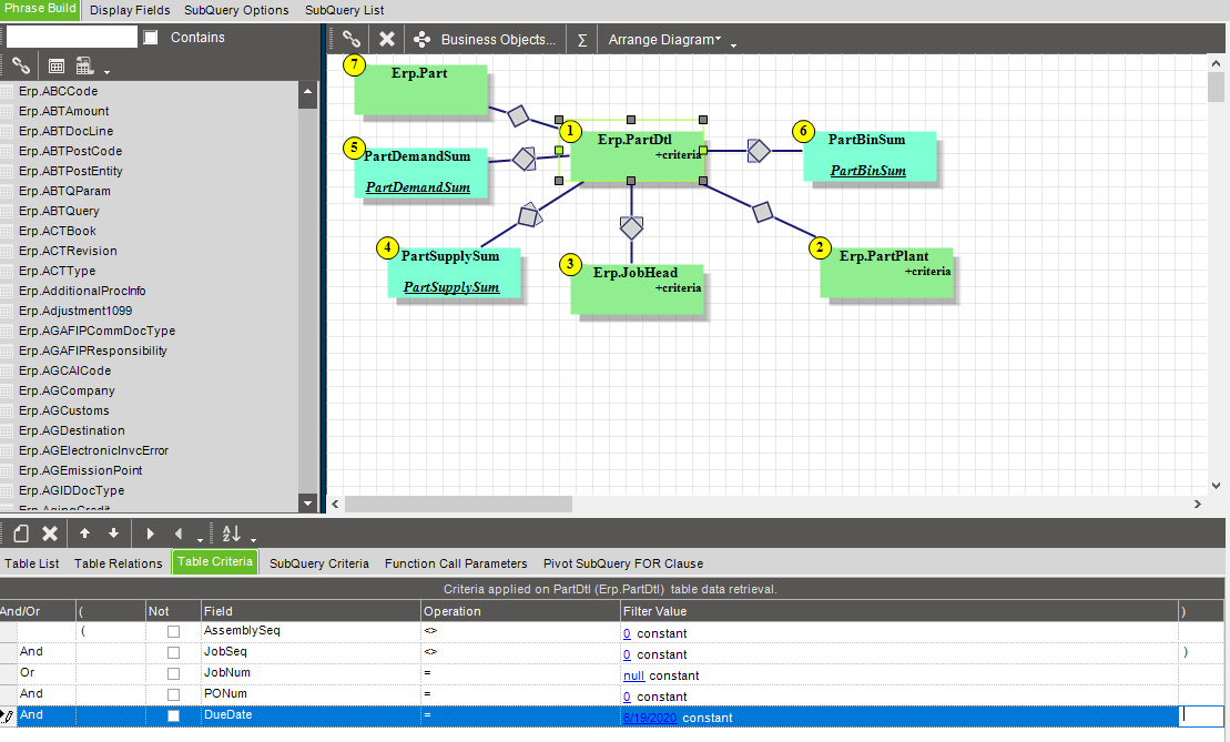

I have another somewhat similar issue as well. I would also like to filter out requirements that have Assembly sequence of 0 and Job sequence of 0 (0/0 upper level materials). I would also like to exclude POs but still include Sales Orders. Here is what I have as table criteria for the PartDtl table but this is not correct as I am getting materials for many different dates.
*I will take out the criteria that dictates the due date as a constant date but for testing the BAQ it should work.

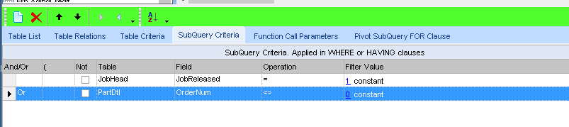

Add a subQuery criteria. And you no longer need the table criteria on JobHead.
Something like:

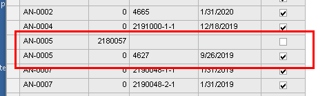

Without that SubQ criteria I get all records. Note that P/N AN-0005 has a SO demand and two Job Demands (one released and one not)

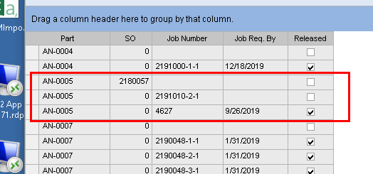

With the criteria I get
Thanks Calvin. That has helped a lot. I haven’t played with how to use Subquery criteria very much.
Jakob
I think of the SubQuery criteria as a way to filter the results of the query, after any table and/or relationship conditions are applied.
