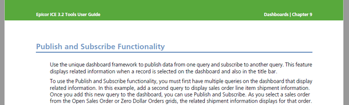

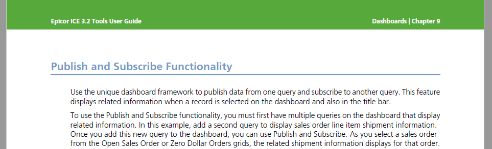

The EpicWeb ICE Tools guide (for your version, though they are mostly all the same) has a section on this:
(It’s much longer; just showing a preview.)

Basic idea is this:
  1. Create 3 BAQs [I’ll explain more at the end]
    a. Part numbers, part description, Qty OH and not much else
    b. Open sales order lines (part number, customer name, qty on order, qty shipped already, etc. to your heart’s content)
    c. Open jobs (part number, due date, qty, etc.)
  2. Create dashboard; start with just 1a
    a. Publish the part number field from THIS BAQ
  3. In the same dashboard, New > Query > pick BAQ from 1b
    a. Subscribe this BAQ’s part number TO the published part number from 2a
    b. It will come in as a tab, but that’s silly for something small. Drag the tab to be a split screen with the first BAQ (one on the left half and one on the right half, for example). Also, you may need to refresh just this pane - and only because you just now created it.
  4. Test this by clicking different part numbers in the first grid. The second grid should instantly change and show order lines for the newly-clicked part number
  5. Repeat step 3, using the BAQ from 1c.

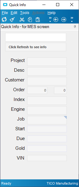

Question: In the dashboards is there a way to ONLY show the Tracker View and NOT the Summary view?
Thanks!
The grid? Just delete it, right? (Save first; there is no undo or warning!)
I do feel like I have regretted that in the past, though. I don’t remember why…
Edit: No I guess it’s fine. Here is one I made years ago that is only a tracker:
