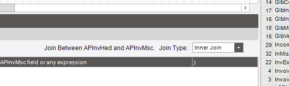

Change your join of the two tables to include all of PO’s. Then you will get a list, and you can filter by the rows that don’t have a invoice attached (null)
Mine looks different from that. The only join options I have are Inner, Left, Right and Full. Would this be a version difference?

Yup, that changed from 10.0 to 10.1. (big issue in the nerd world I heard) It’s the same thing. Look at the symbol on the join to help determine. the squared brackets mean all of that table.
