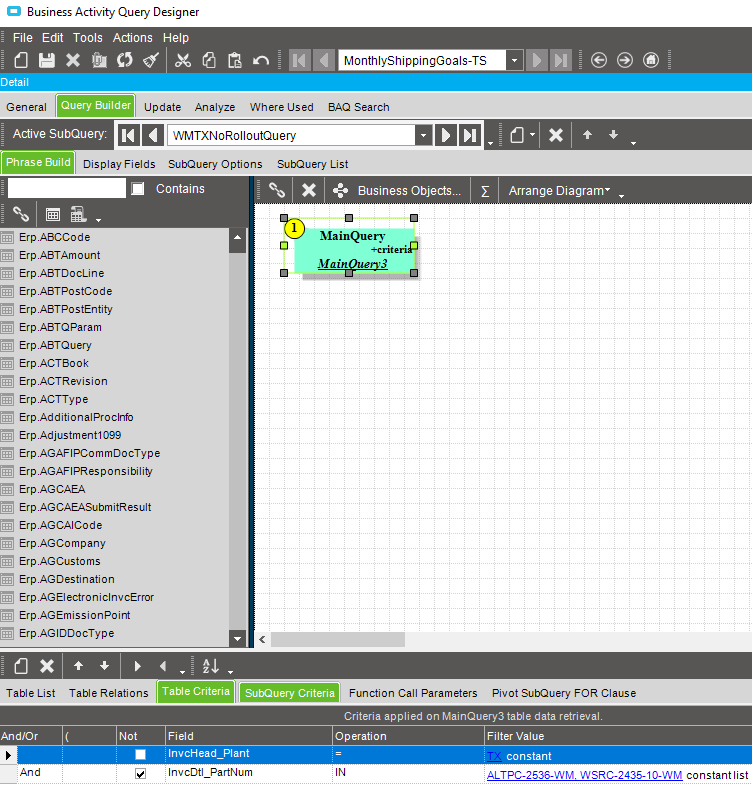

I elected to do this using a technique in the BAQ Course - Create a top level query, inner subquery, and union the remaining queries based on their unique criteria. I will screenshot the BAQ pages to present some clarity.

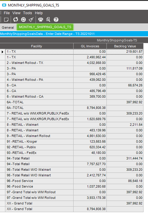

Here is the dashboard output:

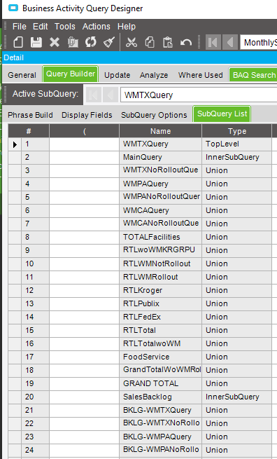

To Continue, here is the subqueries list. There are more BKLGs (one for each of the top queries).
Invoice Query:

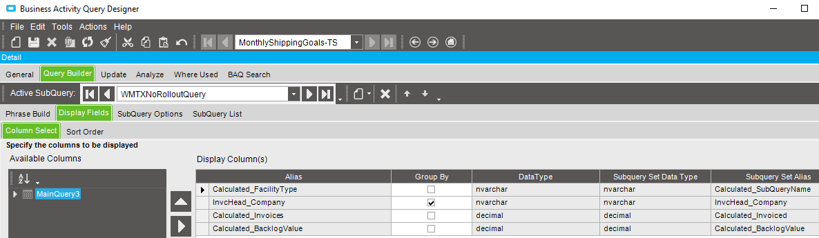

Display Fields:

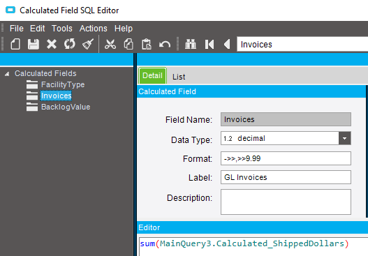

Calculated fields:
The BacklogValue field is set to 0. In the BKLG queries, I do the opposite. Set the Invoices = 0 and sum(OpenValue).

Instead of the union, bring both of the subqueries into a top level query and join on Facility.
Hi Brandon, Thanks for looking at this BAQ. I already have a Top Level Query for the data. The remaining subqueries are unions to it. The Facility field is a calculated field created by me to sort the data as well as designate the criteria. How would I be able to create another top level query? I need the union to represent the disparate types of data. They are even using different date ranges. I have 4 parameters (invoice start / end dates, backorder start / end dates). Not a standard type of reporting to put backlog and invoices together, but… do you have time for call / TEAMS or is it usual to continue in the forum?

I don’t know that I would have constructed the query in that way, but you could probably set the top level to a subquery and make another top level that groups and sums the columns to get them on a single row.
You’ll have to add some parenthesis in the subquery list to make that work.
