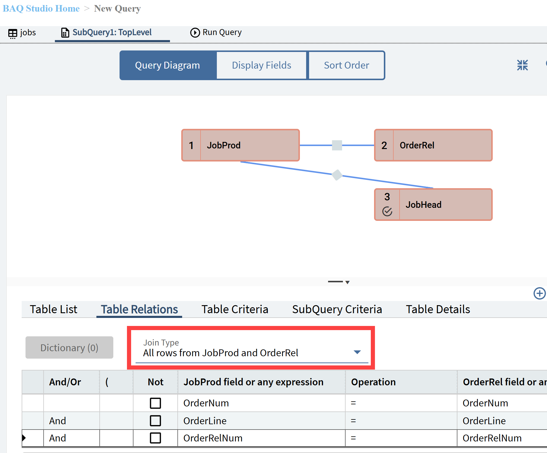

Good morning,
I am setting up a relatively simple BAQ. I want to see:
- All the open sales order releases
- All the open jobs linked to releases
- All the open jobs not linked to releases
I got the first two working in this BAQ. However, I want to find a way to add that last part to see if there are jobs out there that are make to stock, or otherwise not linked to a sales order. Here is the simple BAQ I have:
