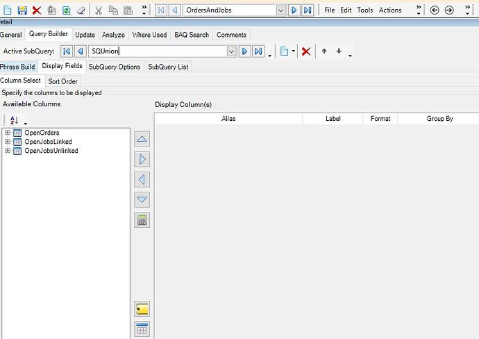

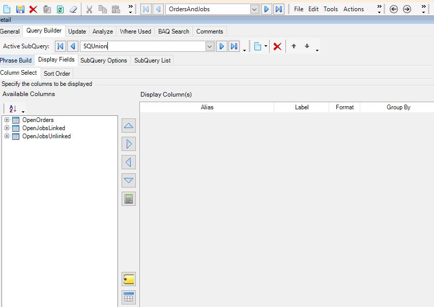

I think this is close, but I don’t know how to get fields into the Union. I have all three subqueries in there with the same number of fields. With the top level in place, I can save it for review:
OrdersAndJobs.baq (115.1 KB)
I think if I had the fields in the union, then they would work at the top level. I am still missing something important.

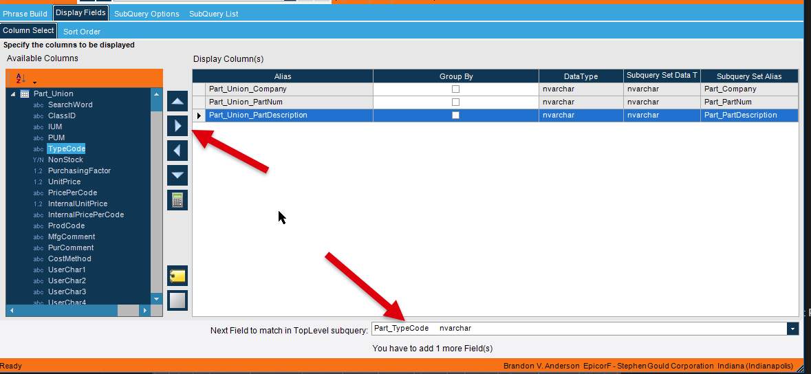

Just add them. It’s just a subquery. This text box down here gives you a hint on what the next one is looking for.

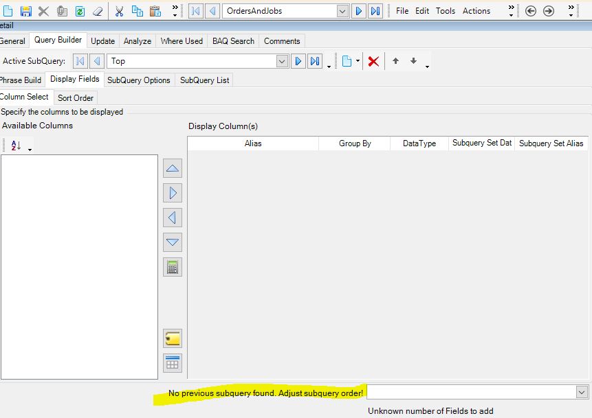

I don’t have anything in the top query, so that box is blank. I’m so confused!

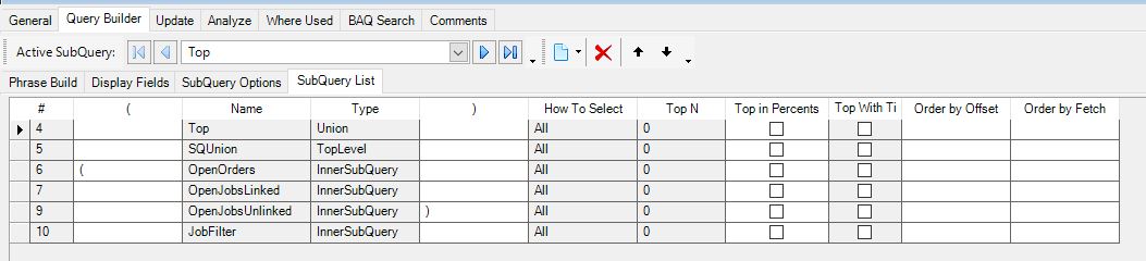

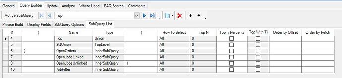

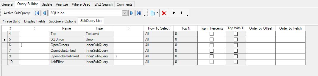

Switch it then. Make your “union” the top query, and the top query the union.
Now I am even more confused.

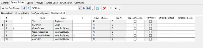

You gotta change the order on the subquery list too!
And put parens around the union and top levels.

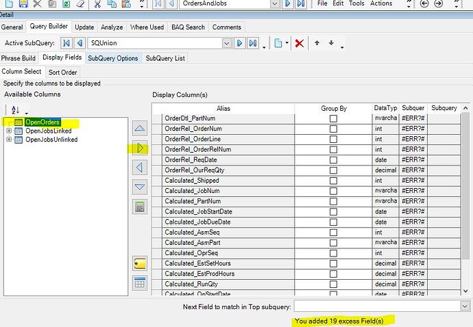

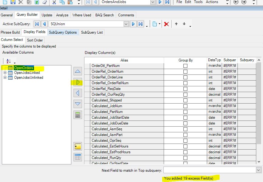

That helped. I can now get some results into my union without an error. I added the order subquery fields to the Top (Union), and to the SQUnion (Top). But how do the values from the other two subqueries get in there?
OrdersAndJobs.baq (125.1 KB)
Change them to a union as well if you’re trying to stack them all together.

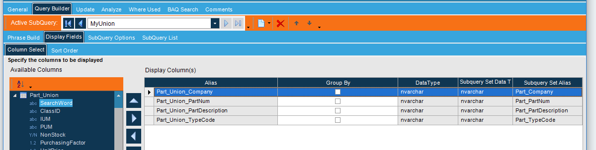

Just thinking out loud here… Put your current BAQ aside for the time being and start with a fresh simple one with a top level and two tables with just one or two fields using the union… and work on getting that right, then apply your leanings to your existing BAQ…

I didn’t want to guide you too much :wink: , sometimes the learning happens during the struggle. But, yeah, to lean into what @Hally said, what I would probably do in your case for this is do the unioning with the bare minimum data, then on a true top level, do the joins for the informational extra stuff once so you don’t have to bring in all those fields to every union. But you’ll need to understand how to manipulate the unions, which you are learning to do now.
Just remember that query order matters, and parenthesis matter when you’re doing unions.
