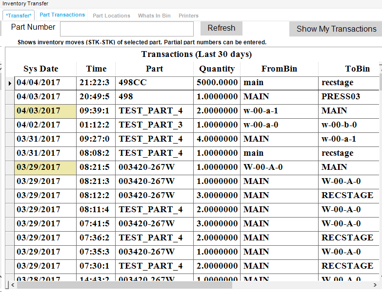

You also could possibly set DefaultAppStyling to false on the grid, then increase the font size and even increase the grid cell height to add space and better visibility.
I’ve done that here (not an extreme case) as well as add some color rules based on code.
Changing (adding) font to grid:
//Fonts for my panels
System.Drawing.FontFamily ff = new System.Drawing.FontFamily("Times New Roman");
System.Drawing.Font f = new System.Drawing.Font(ff,14,System.Drawing.FontStyle.Bold);
epiUltraGridXfers.Font = f;
epiUltraGridPartLoc.Font = f;
epiUltraGridBin.Font = f;
PrinterGrid.Font = f;
//hide a column
PrinterGrid.DisplayLayout.Bands[0].Columns[0].Hidden = true;
//set a width
PrinterGrid.DisplayLayout.Bands[0].Columns[1].Width = 150;
