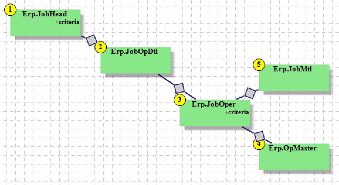

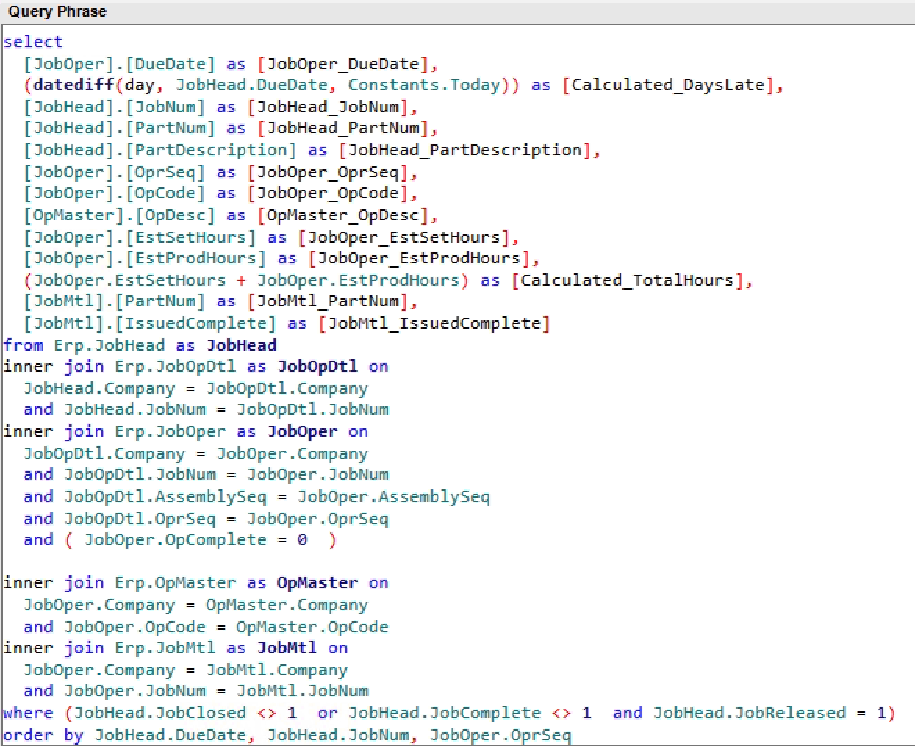

This is what the BAQ looks like.
And you only want to display operations where the job materials are not issued complete, correct?
Other way around: display Ops where the job materials ARE issued complete (that way they know what work to do next)
