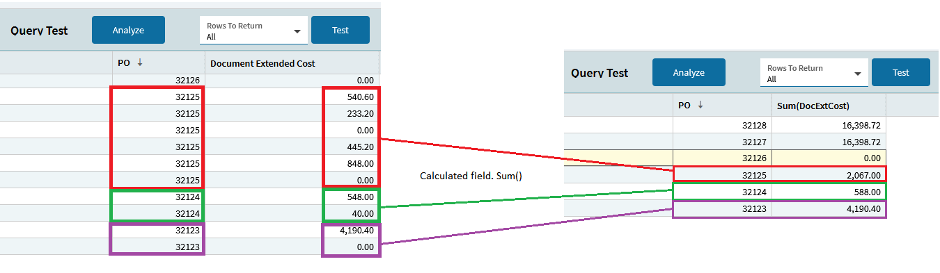

Using a basic query here with PODetail:
  1. Left BAQ shows no Group By.

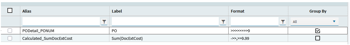

  2. Right BAQ shows Group By on the PO Num.
DocExtCost is a calculated field where I have done a sum:

In this example, I am getting those duplicate rows because this is the PODetail table. Each “duplicate” PO num is actually a different line in the PO!
2 lines on PO 32123:
32123/ 1
32123/ 2
6x lines on PO32125:
32125/ 1
32125/ 2
32125/ 3
32125/ 4
32125/ 5
32125/ 6
I don’t see the PO line numbers because I havent selected it for my BAQ, nor do I particularly want to see it on this report.
This is where Group By comes in. I can group all of those rows with the same PO number and sum the corresponding DocExtCost fields.
