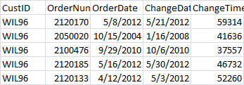

(I added the condition of CustID=‘WIL96’ just to limit the results for this example. The same results happen w/o the CustID limit)
BAQ with Phrase:
for each Customer where ( Customer.CustID = 'WIL96') no-lock , each OrderHed where (Customer.Company = OrderHed.Company and Customer.CustNum = OrderHed.CustNum) no-lock .
returns:
BAQ with Phrase:
for each Customer where ( Customer.CustID = 'WIL96') no-lock , last OrderHed where (Customer.Company = OrderHed.Company and Customer.CustNum = OrderHed.CustNum) no-lock .
Returns:
OrderNum 2120133 is obviously not the last by this customer

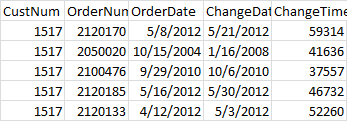

Can you include the ChangeDate in your results to see if it is using the ChangeDate Index…….
Here’s the BAQ output (for EACH)
using LAST, returns 2120133 - the last in the list but not the last Order created or changed
using FIRST, returns 2120170 - the first in the list but not the first Order created or changed
