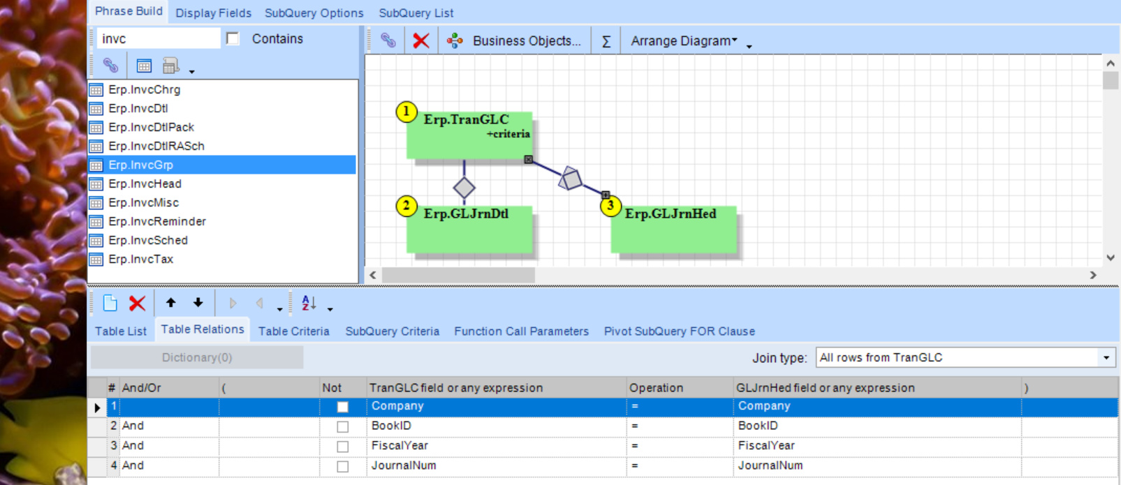

I have tried several different scenarios and I am close but not quite there. Below is the query and the fields I have related. I can get the exact number of Rows I need but it will not populate the entered by for each row.
Below is the sql. I have tried moving the GJrnHed to an Inner Subquery as well as tried to create it as a UnionAll it will provide some of the entered by from the table.

left outer join Erp.GLJrnHed as GLJrnHed on
TranGLC.Company = GLJrnHed.Company
and TranGLC.BookID = GLJrnHed.BookID
and TranGLC.FiscalYear = GLJrnHed.FiscalYear
and TranGLC.JournalNum = GLJrnHed.JournalNum
where (TranGLC.FiscalYear >= 2018 and TranGLC.JournalCode = ā€˜CR’)
and TranGLC.RelatedToFile = ā€˜CashDtl’ or TranGLC.RelatedToFile = ā€˜CashHead’
order by TranGLC.Company, TranGLC.FiscalYear, GLJrnDtl.FiscalPeriod, TranGLC.JournalNum, TranGLC.JournalLine, TranGLC.CreateDate, GLJrnDtl.JEDate, GLJrnDtl.PostedDate
I am open to suggestions but bear in mind I have to see each GL transaction for the GL Code CR (Cash Receipt). I know this comes from the CashHead and CashDtl Tables. But getting my query to pull in the entered by or each transaction has been the challenge.

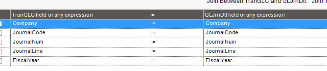

Perhaps you dont have enough criteria (relationships) on your GLJrnlDtl
All I see is:
TranGLC.CorrAccUID = GLJrnDtl.CorrAccUID
@Chris_Conn, That is the only criteria I need. If I add any other criteria, it will provide Zero Results. I’ve tried a few different criteria.
Charles
Ah I confused myself again. Just move your head link to be under (and connected only to) the JrnDtl. Also, make it an inner join (you cant have a detail without a head anyway)
@Chris_Conn,
I have tried this and I zero results. That’s why I moved it to be connected to the TranGLC table.
I’d try again and make sure you didnt get anything confused. There is no way you would not return the head, if you are returning details.Judging from the inner join you have on details, you must be returning them.
I’m pretty sure that GLJrnHed records only exist for manual Journal Entries.
A quick query of GLJrnlHed only returns records with JournalCode of ā€˜GJ’
Where as GLJrnDtl has records with JournalCode of GJ, IJ, PJ, and SJ
Edit: So move the link from TranGLC - GLJrnHead to be GLJrnDtl - GLJrnHed, and keep the left outer join.
