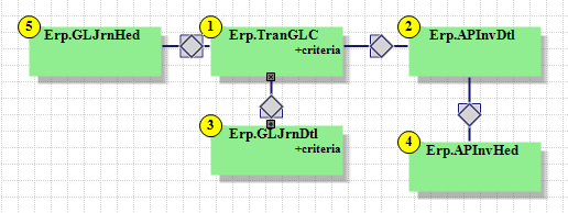

The end goal here is to pull data similar to the Chart Tracker, but for the payments to include the Part Number and Description from the APInvcDtl table. I don’t see these on the Chart Tracker.
I’ve set up a BAQ the links the APInvDtl, TranGLC, and GLJrnDtl to get the majority of the data based on GL Code, and FiscalYear and FiscalPeriod.
My current problem that I am pulling Payment Journals (PJ) correctly, (I believe because they exist in TranGLC) but not the General Journal Entries (GJ).
Attached is the query along with a screenshot of the BAQ.
Am I overthinking this entire thing?
:slight_smile:

select
[TranGLC].[Key2] as [TranGLC_Key2],
[APInvDtl].[InvoiceLine] as [APInvDtl_InvoiceLine],
[APInvDtl].[PartNum] as [APInvDtl_PartNum],
[APInvDtl].[Description] as [APInvDtl_Description],
[TranGLC].[CreditAmount] as [TranGLC_CreditAmount],
[TranGLC].[DebitAmount] as [TranGLC_DebitAmount],
[TranGLC].[GLAccount] as [TranGLC_GLAccount],
[TranGLC].[GLAcctContext] as [TranGLC_GLAcctContext],
[GLJrnDtl].[FiscalPeriod] as [GLJrnDtl_FiscalPeriod],
[GLJrnDtl].[PostedDate] as [GLJrnDtl_PostedDate],
[APInvHed].[InvoiceDate] as [APInvHed_InvoiceDate],
[TranGLC].[JournalCode] as [TranGLC_JournalCode]
from Erp.TranGLC as TranGLC
left outer join Erp.APInvDtl as APInvDtl on
TranGLC.Company = APInvDtl.Company
and TranGLC.Key1 = APInvDtl.VendorNum
and TranGLC.Key2 = APInvDtl.InvoiceNum
and TranGLC.Key3 = APInvDtl.InvoiceLine
left outer join Erp.APInvHed as APInvHed on
APInvDtl.Company = APInvHed.Company
and APInvDtl.VendorNum = APInvHed.VendorNum
and APInvDtl.InvoiceNum = APInvHed.InvoiceNum
right outer join Erp.GLJrnDtl as GLJrnDtl on
TranGLC.Company = GLJrnDtl.Company
and TranGLC.FiscalYear = GLJrnDtl.FiscalYear
and TranGLC.JournalCode = GLJrnDtl.JournalCode
and TranGLC.JournalNum = GLJrnDtl.JournalNum
and TranGLC.JournalLine = GLJrnDtl.JournalLine
and TranGLC.CorrAccUID = GLJrnDtl.CorrAccUID
and ( GLJrnDtl.Company = ‘ACYT’ and GLJrnDtl.FiscalPeriod >= @BeginPeriod and GLJrnDtl.FiscalPeriod <= @EndPeriod )
full outer join Erp.GLJrnHed as GLJrnHed on
GLJrnHed.Company = TranGLC.Company
and GLJrnHed.BookID = TranGLC.BookID
and GLJrnHed.FiscalYear = TranGLC.FiscalYear
and GLJrnHed.JournalNum = TranGLC.JournalNum
where (TranGLC.Company = ‘ACYT’ and (TranGLC.RelatedToFile = ‘APInvExp’ or TranGLC.RelatedToFile = ‘APInvHed’ ) and (TranGLC.GLAcctContext = ‘Expense’ or TranGLC.GLAcctContext = ‘Payables’ ) and TranGLC.FiscalYear = @FiscalYear and TranGLC.GLAccount = ‘03180|03|80197’)
order by TranGLC.Key2
Looks like I needed to just do a left join from APInvDtl to APInvHed . . .
I’ll see myself out.
Thanks for looking!
