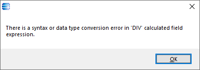

Hello Greg,
I am putting the code you provided as a calculated field in Epicor 9 and I get the following error.
Thanks for your help.

LOL That’s not gonna work. I just assumed you were 10 regardless of your version in your profile. Let me look.

so this is a guess based on my old notes. It just takes out the assignment.
IF INDEX(Part.PartDescription,“FRV PART#”) <> 0
THEN "VK"
ELSE
IF Part.ProdCode = "FRMC" THEN "FRMC"
