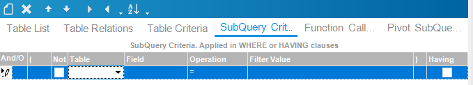

Hi Vicki,
One thing that can help (if you have it in 10.1.400 :thinking:) is the SubQuery Criteria:
If you link your JobOper with your Labor Details, you can then compare values from two different tables like Operation Complete Date and the Labor Detail record.
