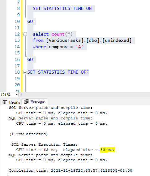

I tested this to see it in practice and on an unindexed table with 1 million rows and 2 columns, first column static and indexed the run time was almost 50% faster. Table looks like this:
This is stat for running on unindexed table:
And here is the stat for running on the same table but indexed on Column Company (all values in this column are the same and A):
Thank you @jgiese.wci and @josecgomez for educating me!
