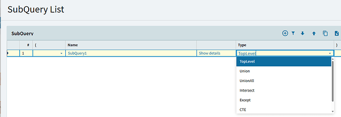

Do you know about the types of sub-queries you can create in a BAQ?
Edit: InnerSubQuery is the last entry in that list.
