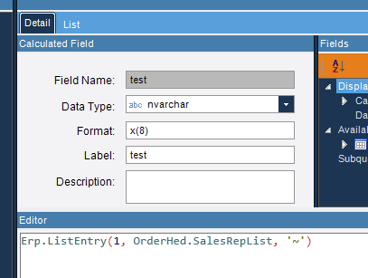

Can we use ERP.ListEntry() T-SQL function in BAQ?
Here’s where I saw it mentioned:
PS - any on-prem’rs wanna share a db create script or .dacpac of 2025.1 db?
You should be able to. The scalar function is there. I’ve never use it myself.

Looks like it’s the same is Ice.Entry()
Thanks. I thought maybe you were referring to c# w Ice.Entry().
Any idea whether @idx is zero or 1 based? Guessing 1-based.
0 based.

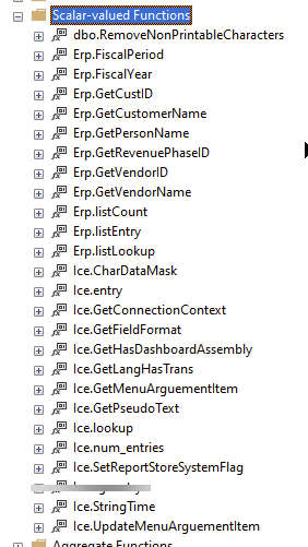

here’s the list of scalar functions. (the blurred out one is one we added)

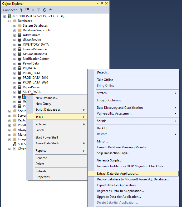

Probably won’t work, but a .dacpac is a file made by SQLPackage utility (built-into SSMS, SSDT, ADS, & MSSQL VSCode Extension) which can be used to create an empty database. Basically it’s the publish output of a VS Database Project.
