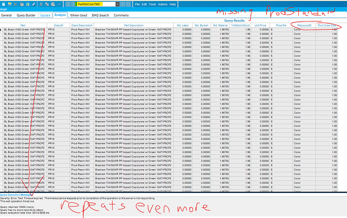

BAQ listing parts and standard cost info are duplicating parts!?

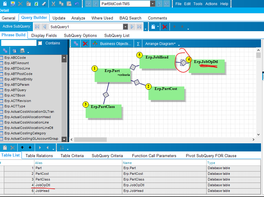

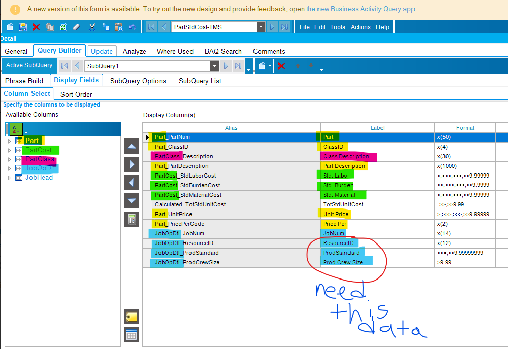

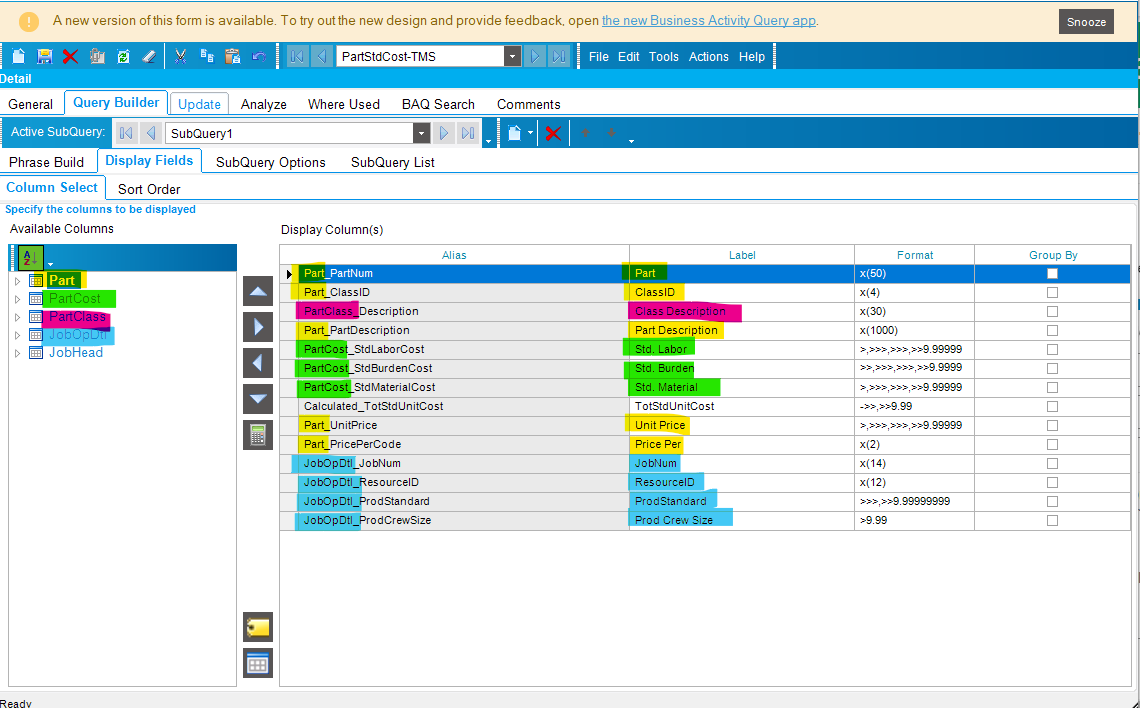

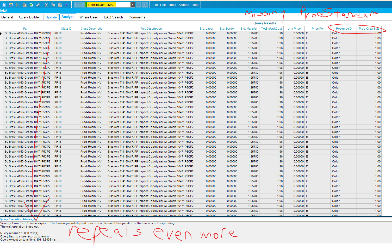

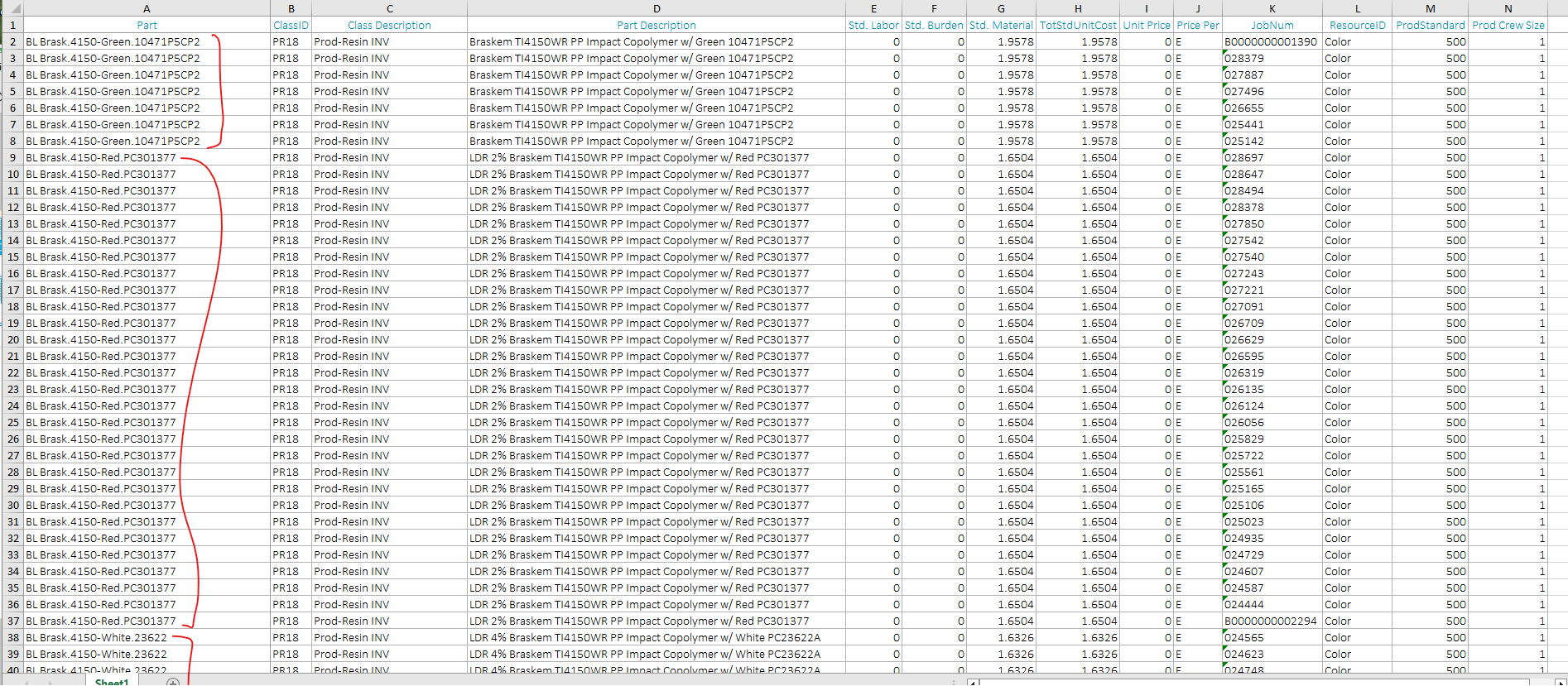

Parts are duplicated when running a BAQ listing parts and their standard cost info, etc. I originally did not have JobNum as a field and added it to see that the JobOpDtl data (ResourceID, ProdStandard, and ProdCrewSize) might be based off the JobNum since the JobNum is different, but when I deleted all four fields (JobNum, ResourceID, ProdStandard, and ProdCrewSize) the parts were still duplicating…
Any ideas how to eliminate all the duplicates?

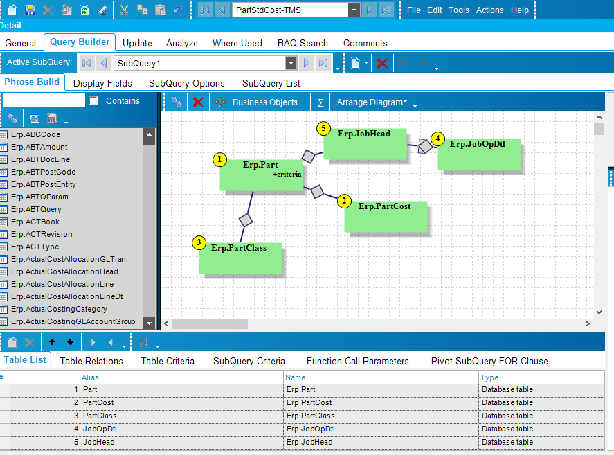

You have job number on there you are getting one row per job
Deleting the field does nothing the join to job is bringing one row per job

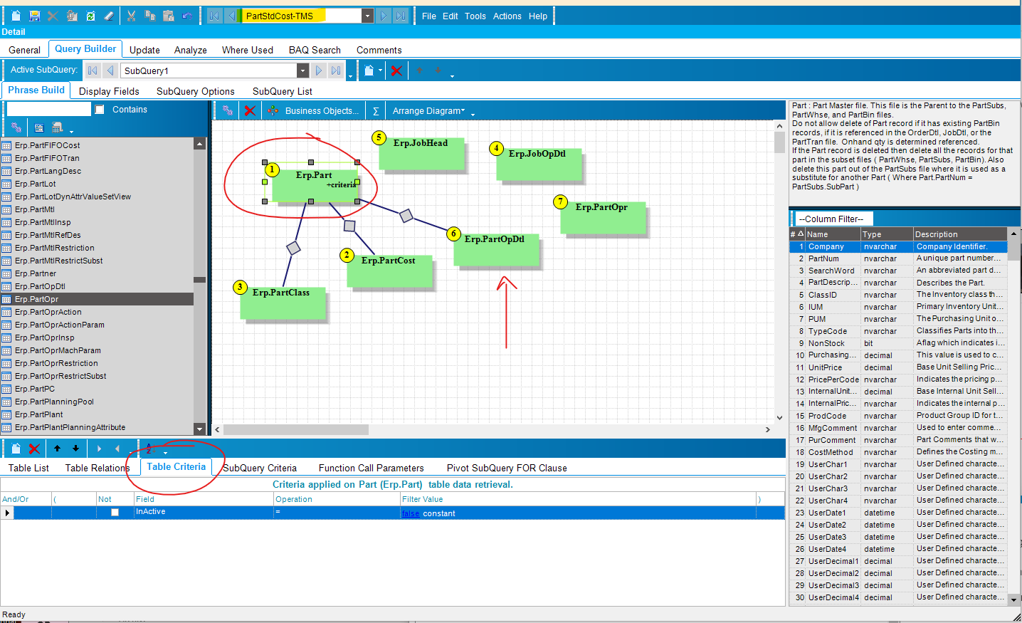

I need more information/help. Are you saying to delete the join below? If so, then how will I get the following fields of data since they come from the table you say to unjoin?
If you need job data you are going to have an entry per job oper detail
If you want to get part cost, delete everything related to transaction. Mean delete table JobHead/ JobOpDtl.
So, my question is how to get those 3 fields along with part cost detail? Are the 3 fields (ResourceID, ProdStandard, and ProdCrewSize) that are within the JobOpDtl table also somewhere else? Meaning, what other table can I link to this part info where it won’t repeat the parts since those 3 fields (ResourceID, ProdStandard, and ProdCrewSize) do not change at all, not with a different job number nor anything else.

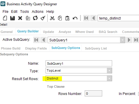

Well, there’s always “Distinct.” It’s a crutch, but I’ve certainly used it.
If you remove the “extra” fields from the Display Fields and set the “SubQuery Options” to Distinct, you may get what you want:

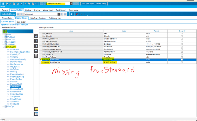

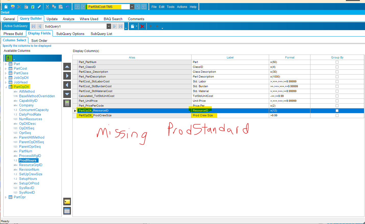

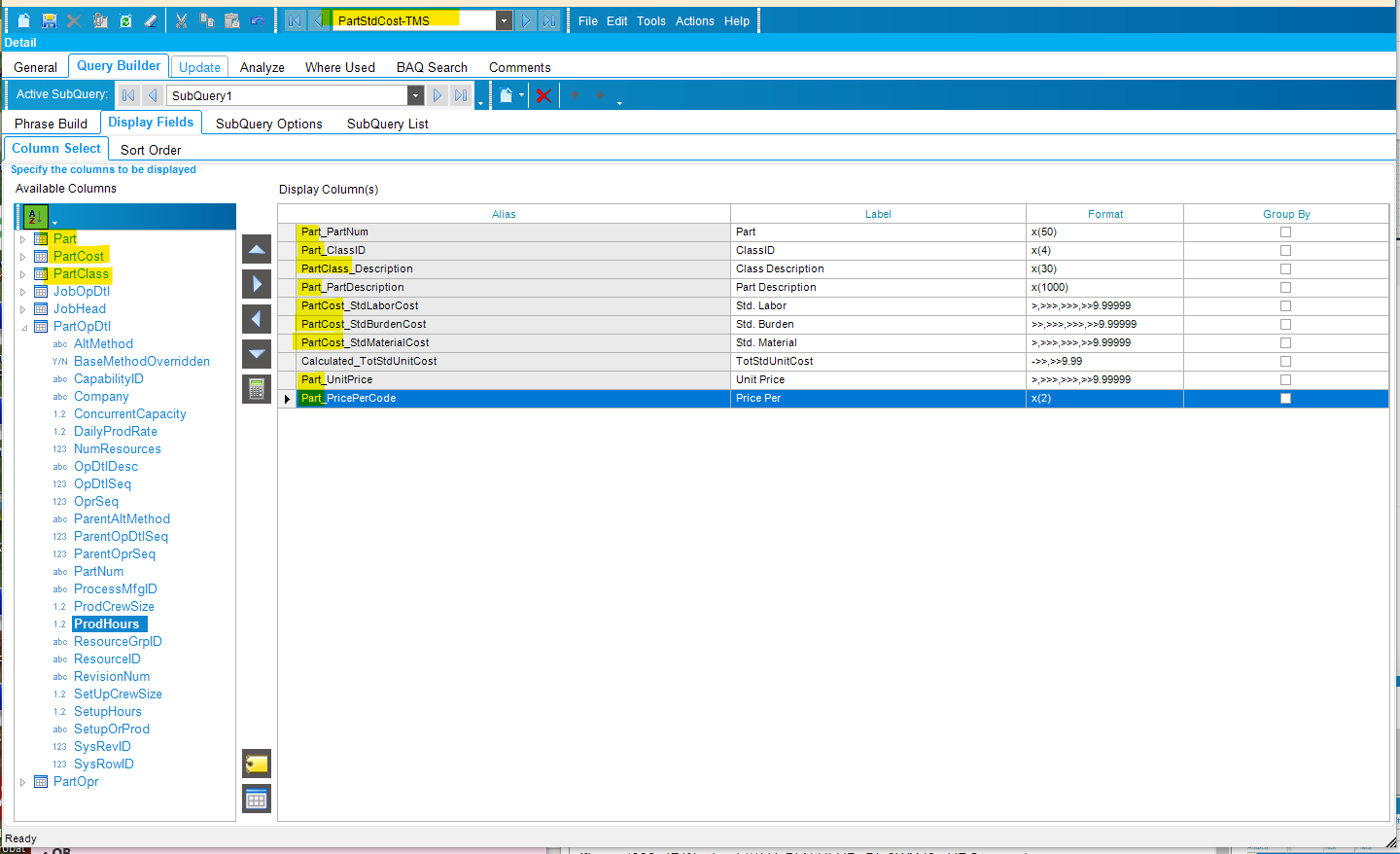

Unfortunately, replacing JobOpDtl with PartOpDtl gave even more rows/duplicates. And, PartOpDtl does not have the field ProdStandard either. I tried the table PartOpr as well and it also gave more rows/duplicates, yet it had ProdStandard but then was missing ResourceID.

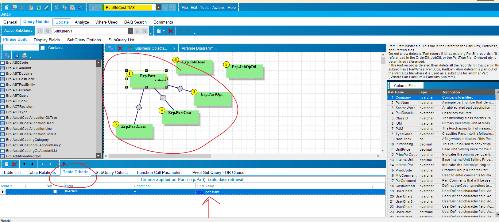

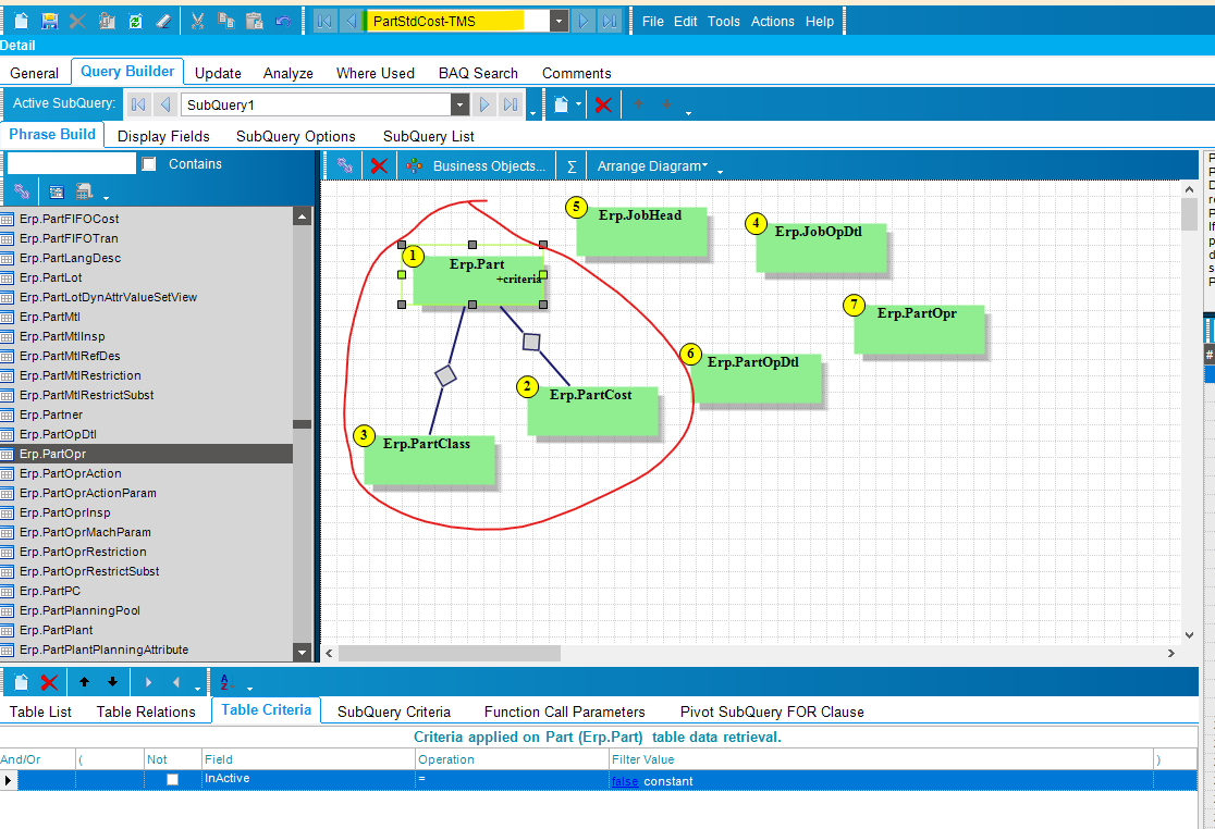

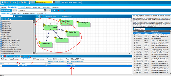

And now I removed all joined tables and kept only the “part” type tables and it timed out, probably because of so many rows. So even the part tables are having it duplicate rows. What am I doing wrong? I just want a list of our parts and the particular fields of the part’s data!?
Dropping in a table with no joins is called a cross join. And that will multiply your records, since if there is no criteria then everything matches.
So if table 1 has 20 rows and table 2 has 10 rows, then you will get 200 results.
If you add another table with 30 rows, you take the 200 x 30 = 5000 rows.
Your tables have a lot more rows than that, and you have more tables than that.
With very rare exceptions, you NEED to join your tables.
Whatever you have going on here… it just ain’t right.

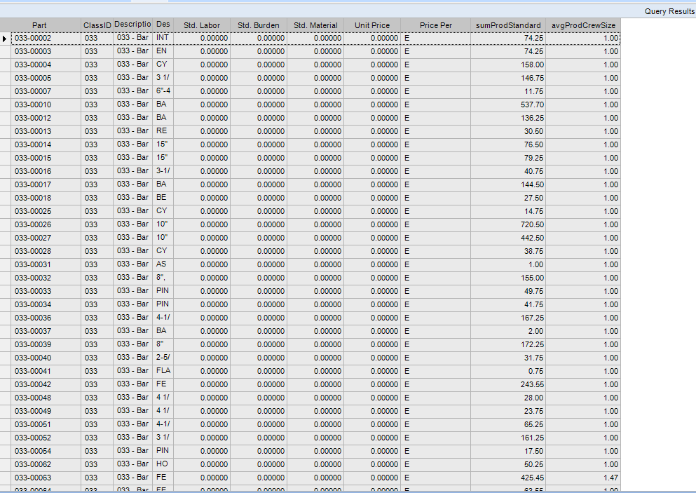

But I was able to recreate and get some aggregate values of ProdStandard & ProdCrewSize… again, going off of my ASSUMPTIONS above.

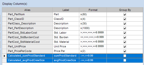

I used the PartOpr table to get ProdStandard & ProdCrewSize values:
I created (2) calculated fields to combine the ProdStandard & ProdCrewSize values:
Query Results: (NOTE… my company doesn’t use Std. Costs, nor add Unit Price values on our parts… so that’s why I’m not getting any results there). But I did get (1) Row per part number:

As I mentioned, I took away all the “job” info, but I was still getting tons of rows (which is what @Banderson was stating), so you can obviously see I don’t know how to properly set up this BAQ (or “join” as he mentioned) to get ONE part per row.
It would be great to have the production details per part I mentioned (ResourceID, ProdStandard, and ProdCrewSize) since these details do not change by job…I just want what production standard we stated for the part, what crew size for the part, etc.

If you don’t understand why they are duplicating, don’t just give up and use the “Distinct” option. That’s setting you up for more issues later. You should know exactly why you need that before you use it.

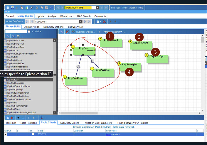

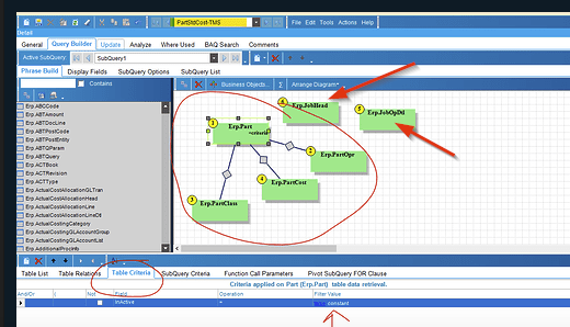

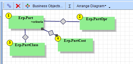

This is what I did and it’s still duplicating. I guess I may not understand join and/or the Table Criteria…does it look right to you?
You can’t leave those unconnected tables in there. (Job head and job op detail). Just disconnecting the joins doesn’t remove them from the query, it creates a cross join. You have to delete them from the canvas.
