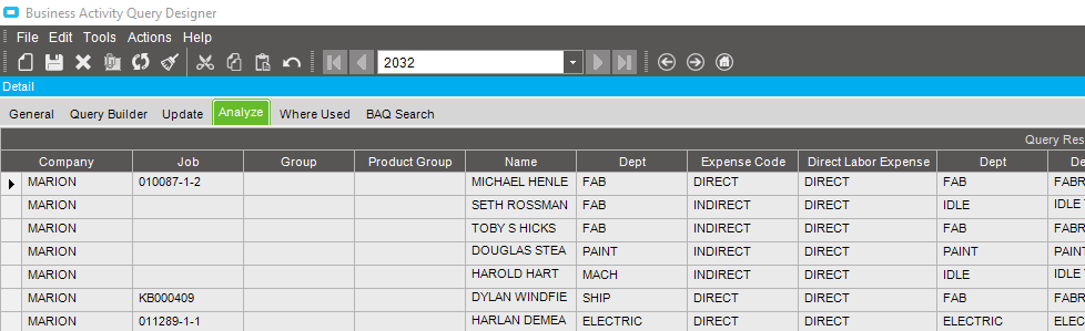

Example below of the data. I pulled for 1/31/20-2/7/20. As you see there is data coming from outside the parameter and not all fields (for the direct job lines) are populated with information (group number, description, etc).
Sometime making adjustments to query joins and criteria can play a little havoc inside the BAQ. After saving, close and reopen the BAQ; check all your filters and joins again - if all seem to be correct, and still getting the same results - try removing and re-adding your date parameters. Without having the full BAQ to analyze and look at, it’s a little difficult to troubleshoot.
Not sure if you’re on-site or cloud hosted; if on-site, I typically try to reproduce the query in SQL Server Management Studio, as it’ll give me much more meaningful feedback as to what issues my query/inner-query(ies) might be having.
You can also try creating you inner queries independently, to see what results they return before joining into the upper level queries. More than likely it has to do with groups or joins - but verify the Date parameters first (iron out as to why records are returning outside of the Date Ranges).
It’s easier to diagnose when you have more limited records against which to analyze.
Sorry I cannot provide more direct guidance at this moment - narrowing down issues in three-layer BAQ’s can be a bit challenging - and it usually ends up being something rather minor which doesn’t jump out immediately.
