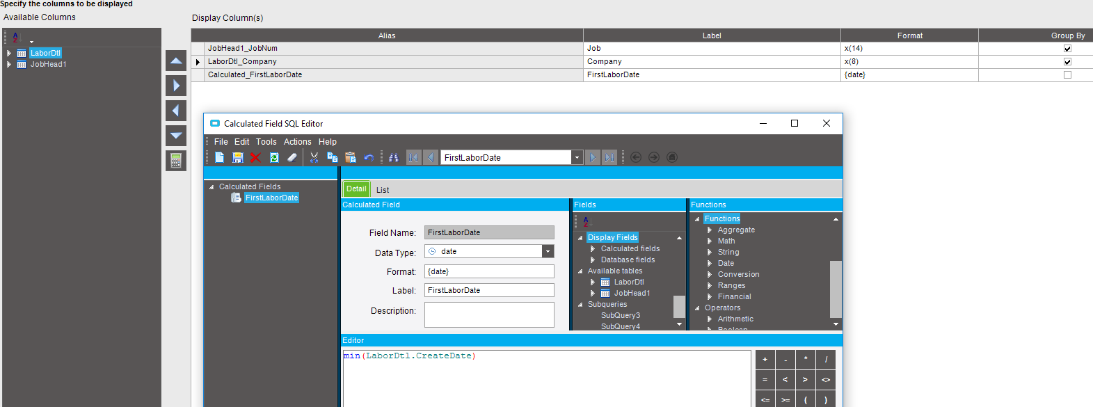

This is my Subquery
this is joined on jobhead on Jobnum.
i also have labordtl left outer joined on jobhead in this sub query. ive tried with just LaborDtl in the subquery and i get the same result…
