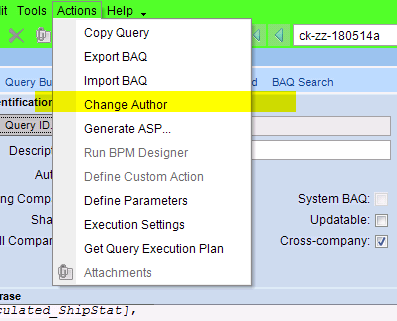

Does E9 have the “Change author” function? Its in the Actions menu of E10
If so, do the following:
  1. Open the BAQ in Production (or where ever you are trying to import it into)
  2. Change the Author to your current user
  3. Import the BAQ that was exported from the test environment - confirming overwriting existing BAQ
Why do I need to change authors if I am overwriting the old BAQ from a new author? Doesn’t this (the author) automatically happen when importing and overwriting an existing BAQ?
In E10, you cant even change a BAQ written by someone else. Well, you can… If you save it as a different BAQ - using either Export followed by an Import, or Copy Query (which will make you the author of the new query). But then it’s really not the same BAQ.
The ‘Change Author’ gets around this.
