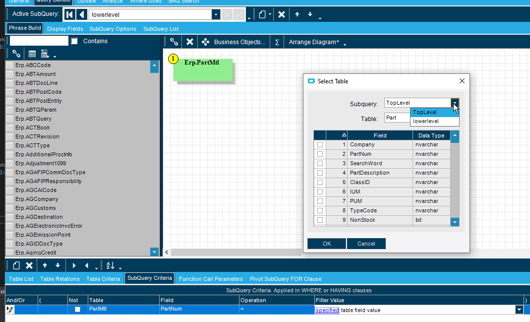

Using 10.2.200.28 and would like to know how to reference a column (from a “parent” top level query) within a InnerSubQuery. Im able to write my query in T-SQL successfully, but 1 line is blocking me to do it from the BAQ editor:

Im unable to do the “UD101A.Character06=JobProd1.JobNum” in the editor, since JobProd1 comes from my top level query. Ive attached the BAQ I have so far if easier (change extension to .baq).
