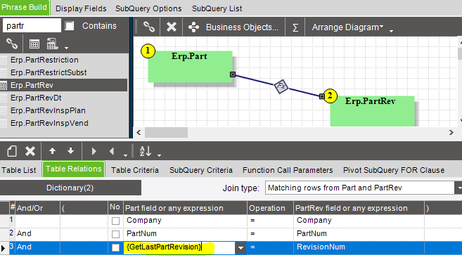

I usually do it the same way you do it when it comes to getting a MAX Value for joining purposes or display purposes (like Last Approved Revision). I typically have much more Sub-Queries bundled together, it makes it much easier.
But if your Query is as simple as it looks, Sub-Query will prob be the best.
But just if you are curious, how a Sub-Select works in BAQ here is more info:
The beauty is you don’t even have to display it to use it in a JOIN, let’s pretend you have SubQuery2 that is a TOP 1 and returns only 1 column. You can just enter it in the JOIN Criteria.
There is always a time and place for it, depending on complexity, and speed. Typically a Sub-Query (not a sub-select) will be faster, but if you are grouping stuff and have groups after groups after groups and wrapped into many queries, its tough to maintain.
Thanks for the links, that helpes find a solution. I did not know you could put a subquery name inside braces.
