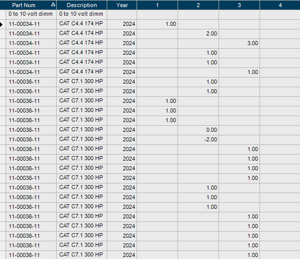

I’m working on a query to show our PO releases to land, broken out by year and quarter. I’ve got the innersub and top level built, but when I go to pivot the top level, I get multiple rows for the same part, and I’m not sure why. I want it to show one part number per row, with the quantities summed up by quarter rather than sporadically. Below is what it looks like when I test it. Below that is the query expression.
