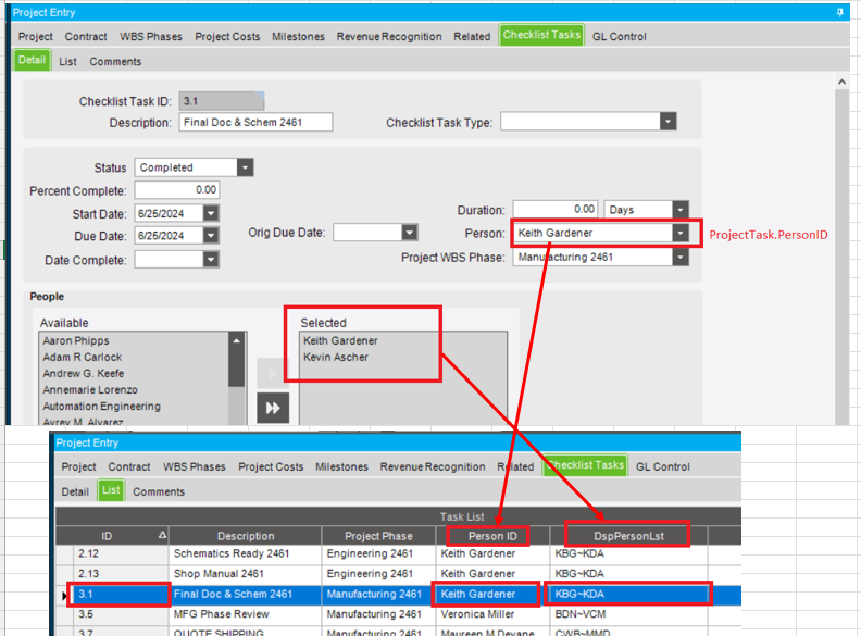

How can I populate the concatenated ProjectTask.PersonIDs into a field on a single row like base Epicor has it in the ProjectEntry->Checklist Tasks->List->DspPersonList field?
I tried the several suggestions in the topic: BAQ: Calculated Field Concatenate Rows to single field but couldn’t get any to work.
This is how it looks in the Project Entry screen and the DspPersonList is what I’m trying to get working in a BAQ so I can display it as a single row in a dashboard.

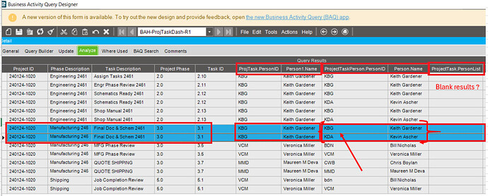

There is a field in the ProjectTask table called PersonList, but it always returns empty in the BAQ. I added the ProjectTaskPerson.PersonID field and it shows the results but on separate lines.

You need to do a subquery with the ProjectTaskPerson table, and do an aggregate function to put them on a single row.
Include the fields that you will need to join it to project (probably company and projectID) group by those fields, and create this calculated field. (you can use whatever you want for the delimiter, I just shoved ~ in there, because that’s what on the screen.
string_agg( ProjectTaskPerson.PersonID,'~')
The bring that subquery into your top level and join it up.
FYI, that link you posted to the For_XML() is before String_Agg() was a thing. It was a hack to do what string_agg() now does, and actually I don’t even think will work anymore as Epicor made it so you can’t use that function.
Thank you Brandon! I’ll give that a try.
Thanks for your advice Brandon! You’re instructions were easy to follow and that solution worked like a charm! Happy Holidays to you!
