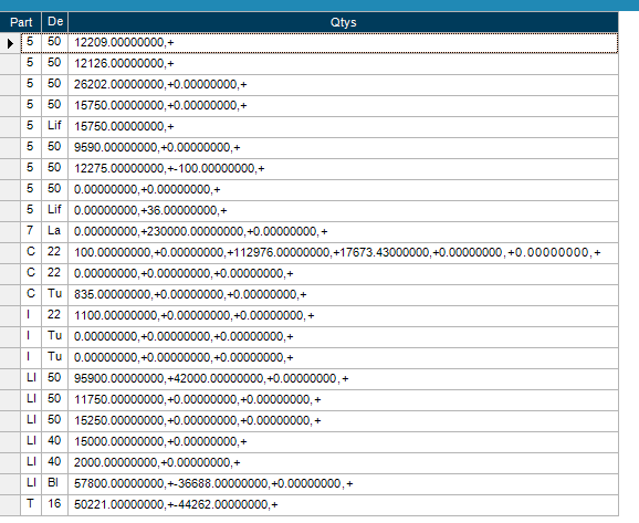

My question is, can I use your example with the REPLACE calc field and add a sum to it? Like in your example, it would be adding up all the order numbers together…
In my example it would be adding up all OnHandQtys for the different locations.
Here’s my query results:
How can I add all the quantities together? Or should I use a different method all together? My goal with this one was to make it all one line instead of having duplicate rows for parts in different locations, and have the total onhand in the last row.
Edit: Also is it possible to remove the zeros at the end of each quantity?
If it was me, I would do another subquery where I used the sum() function and grouped by part number, then you can bring in that subquery like a table and just display the one quantity/part number.
Or grab the OnHand quantity in the Part warehouse table that already has the on hand quantity summed up (although it’s not 100% positive that it matches bin Quantities.)
The top part was it. As usual I was making things more difficult then they had to be.
